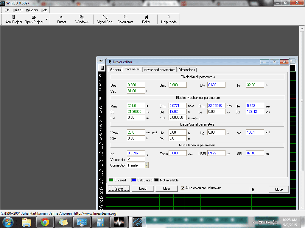

I tried loading the info from him into winisd and there's like 6 inconsistencies, as well as a few of the parameters being nowhere near what's fu lists them as.
Any idea what unit they're using for VAS?
That's the problem, there's an issue with the numbers I got from them. It can't auto calculate because one or more of the measurements aren't right or something. I turned autocalculate off and only entered the info from fu, and it still has half a dozen inconsistencies.
I had no issues entering it in, you also cannot enter it straight like that, you have to enter a number in, hit TAB on your keyboard and let the program do its calculations. You cannot enter things in manually and expect it to work.
Here's what i got. Green numbers entered in; Blue numbers are auto calculated after pressing tab,
I had the same problem. It was driving me crazy. Every time I ran the numbers it would give me a message that the numbers was wrong. I checked and rechecked with no change. Now if I can get a chance to try it again I can get this box finished.. Wish I would have seen this sooner. Thanks for the info Jeff.
