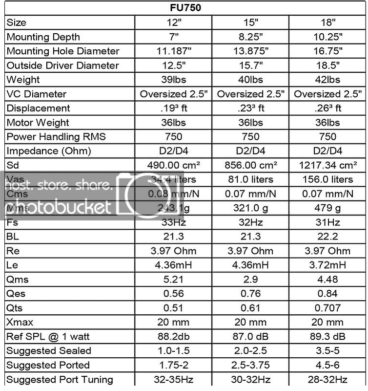

T/S for fu subs?
I have no problems modeling enclosures for these subs in Termpro ....
I've got a set of these in 3.25-3.50^ft test boxes and they play hard all the way down into the 20's .....they are both tuned in the low to mid 30's ....
Can you run a enclosure modeling for me for a pair of 12's? I've been hung up with doctors and don't have Termpro. It would be a big help. Every other program I've tried have come out with wrong numbers and had to put it off to take care of other things. I'm already to build just wanted to have it perfect for these FU subs.

That's cool. It really would help me out so any time you get a chance. I'm still running new wire and cleaning things up. It is for my 03 Astro and will be powered by a Sound Qubed Q1 2200D. Box is for 2 Fu750 12" D4 ohm coils. Max dimensions 40"w X 18"d X 18"h. Port tune around 32hz. Frank recommended 12-14" of port are per cubic ft for daily applications. I think that's everything I can think of. If there is anything else let me know and I'll get back to you asap. Thanks again, this is a real big help right now. I been held up for a while now with the numbers I have. I'll have to check them with what you posted.
