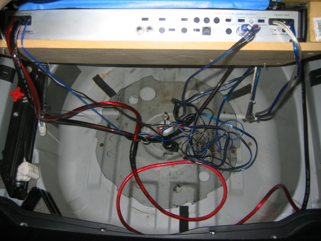

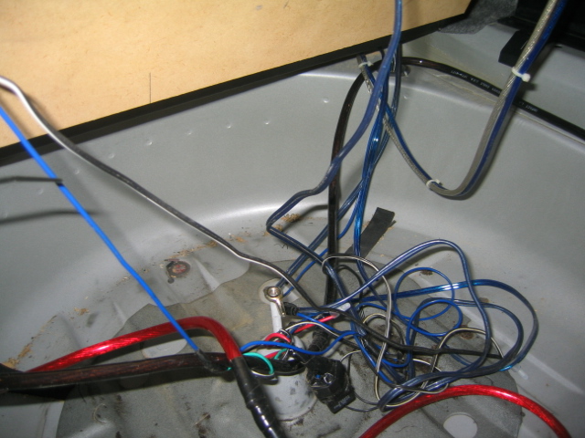

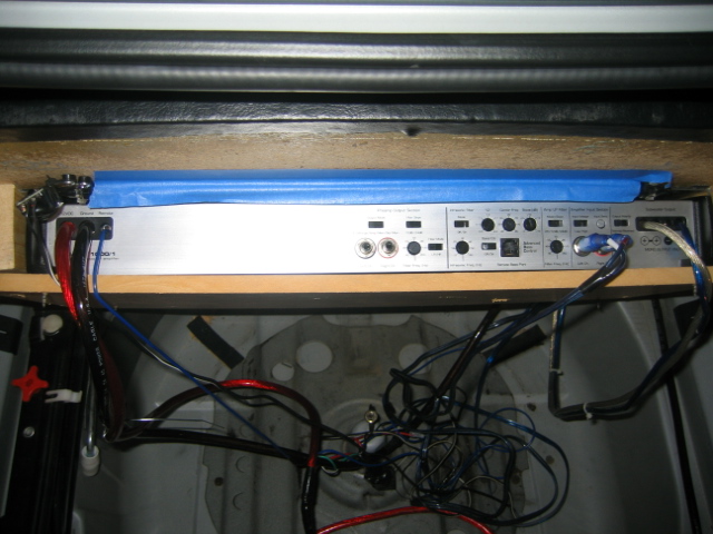

here are some pics of the wiring on the amp side. tell me if anything is wrong.
