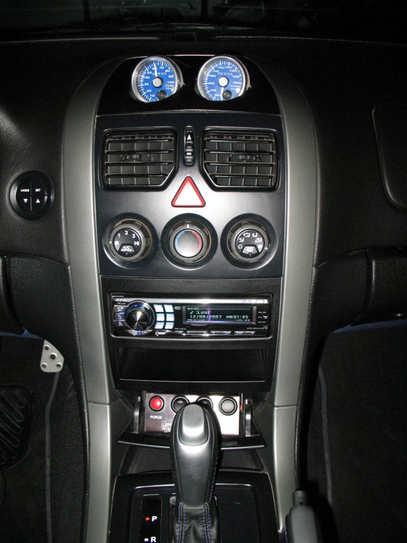

Well this is pretty much the first install I have done without help //content.invisioncic.com/y282845/emoticons/smile.gif.1ebc41e1811405b213edfc4622c41e27.gif
It's pretty much done. All I really have to do is carpet the floor for the trunk... not sure if I should go with black or try to match the OEM carpet already in there. Gotta clean up some wires. Then I need to finish putting the rear interior in and install the steering wheel controls. Oh and of course get with Ant from Second Skin for another Damplifer Bulk Pack to do the trunk. I will add a 6 disc CD changer later... I already miss my OEM one.

HU- Alpine CDA-9887

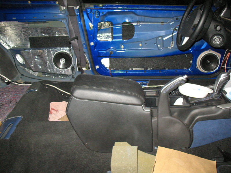

Components- JBL GTO 6.5" (needed 2 ohm to run off the stock HU for awhile, they will be replace when I get the $$$)
Rear Speakers- JBL GTO 6.5" coaxial

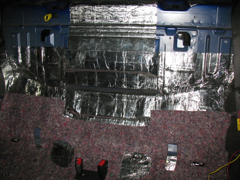

150ish sqft of Second Skin sound deadeners

I see places that need more deadening //content.invisioncic.com/y282845/emoticons/biggrin.gif.d71a5d36fcbab170f2364c9f2e3946cb.gif
And modeling clay...
More deadening will happen... but not a lot, keeping the weight down on this car.

Just another observation, you're losing a ton of potential midbass output because of that large hole in the inner door panel //content.invisioncic.com/y282845/emoticons/smile.gif.1ebc41e1811405b213edfc4622c41e27.gif Seal that up with sheet metal or Plexi, along with the holes above it, and I bet you'll get better results...
