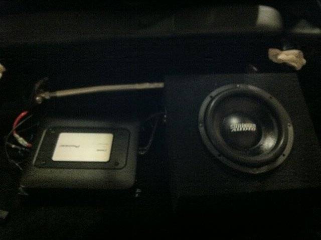

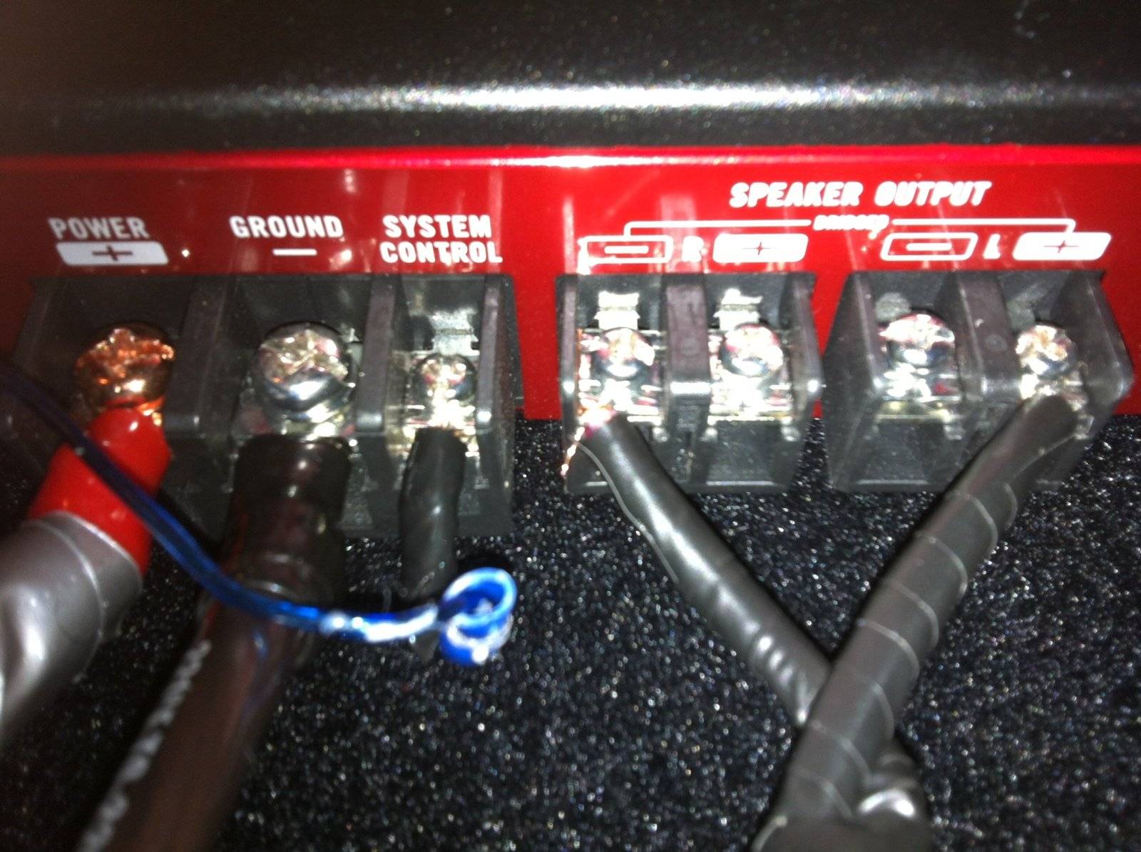

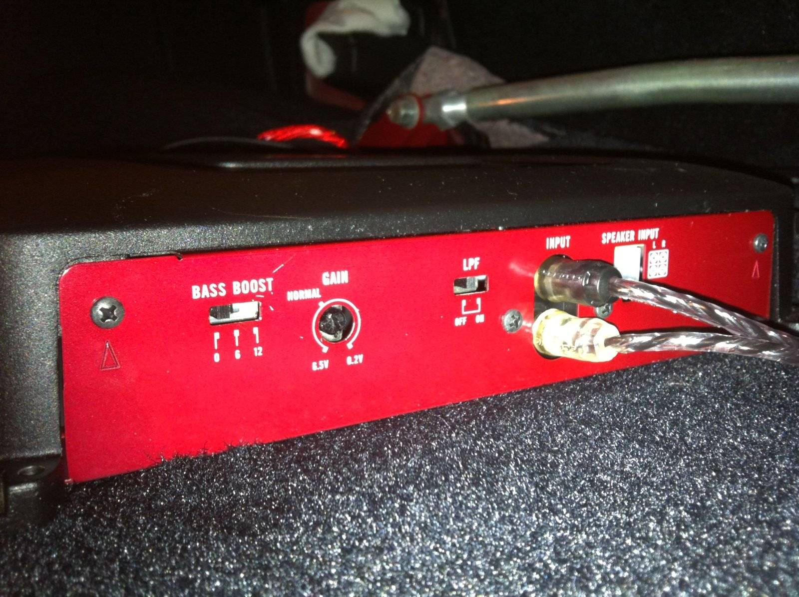

Here are the pics of the install guys
That box is the problem. You can put the best sub in a crappy box and get poor performance. Not like that amp is really doing you any favors, but a prefab sealed box is no place for a woofer like that.
