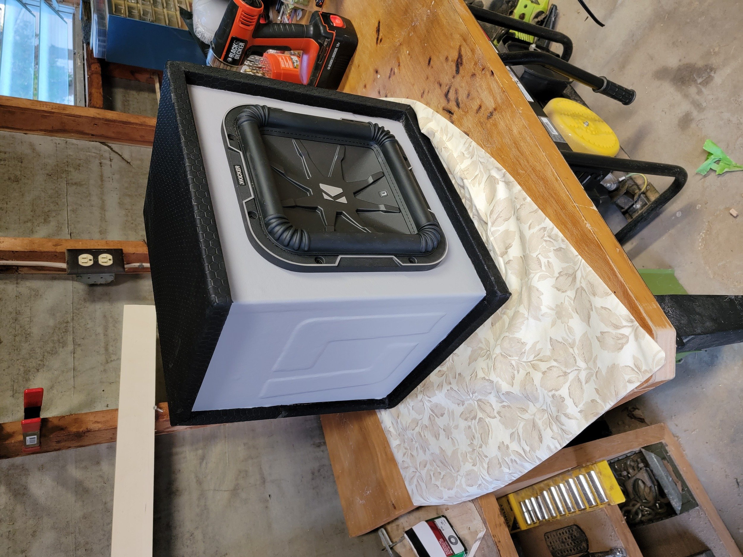

I installed my kicker speakers and amp with no issue, and they sound great. But after finishing the box for my kicker L7 sub and installing it I was very disappointed!
I have a 10" Kicker L7 Q-Class DVC 2 Ohm (paralleled to 1) powered by a Rockford Fosgate R2-750X1. This thing is 750w RMS, so I would think it could put out some serious bass. But.... It doesn't. With bass boost at 0 on the HU, and Punch EQ at 0 on the amp, you barely notice there's even a subwoofer in the car at all!

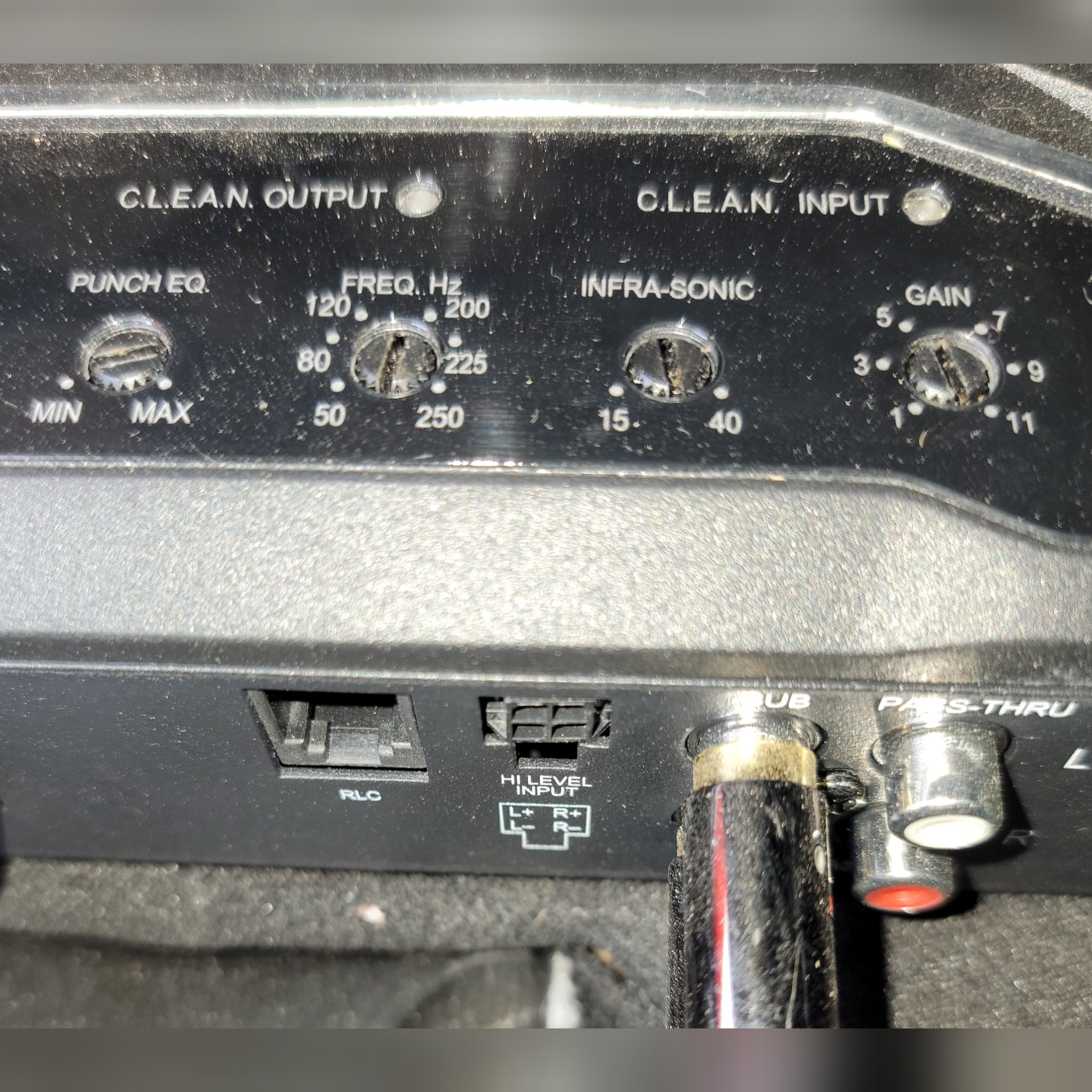

I used a multimeter to set the gain on the sub amp, but found it very peculiar that the C.L.E.A.N. output clipping light was firing off when the gain wasn't even half way up. Voltmeter read the correct voltage for my subwoofer with the gain knob at 11 o'clock.
I actually can get decent bass if I turn up the Punch EQ; which I understand is a bass boost. Which, obviously, is not ideal! I don't want bass in a narrow frequency.. but why would the bass boost be acting more like a gain than the gain?
The HU has a Bass boost setting from 1 to 5. I played with it and got more bass out of the sub, but it doesn't sound good at all. Very muddy, almost like I would need an EQ for the sub itself!

-Can you show us a pic of your amp settings? Gain, crossovers, etc?

I've been playing around with the head unit, and it has both a bass boost and a "SW level" (1 to 10) in the equilizer settings. The sub REALLY came alive at 10.. so I guess that's what I have to do is adjust that to get it where I need?
There is something I'm not understanding though. If the Output clipping light blinks every once and awhile while listening at 0, won't turning these settings up make it clip more? ...to the point of maybe destroying the speaker?

Put the FREQ. HZ. @ 80. Subwoofer level on the headunit at 10 and then adjust the gain.

Also, in deciding the type of enclosure to make I had decided on a sealed box due to the fact that, even though I listen to techno, dubstep, some rap and other "bassy" music, the main type of music I listen to is metal. So the idea was to keep the double-bass kicks very tight with a sealed enclosure.
