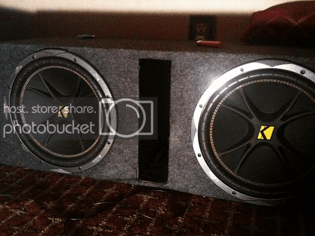

Well Kicker speakers Kick hard. Again I can't say much for SQ but as far as how my system is set up I needed SPL subwoofers. I'm using a box similar to this for the new Kicker Compvr 12"s. I think it's the same box. As you can see it's pretty big. I was going to get the Kicker Vx, CompVX | KICKER but I'll check those out in a few months.
Well Kicker speakers Kick hard! Some of these other speakers non-mainstream subwoofers don't look like they will last long under pressure, but what do I know. I'm using a box similar to this for the new Kicker Compvr 12"s. I think it's the same box. As you can see it's pretty big. I was going to get the Kicker Vx, CompVX | KICKER but I'll check those out in a few months.
^^^^^ No to that. Don't buy an enclosure that wasn't designed specifically for your needs. Looking like it's "pretty big" is a far, far cry from knowing it's correct.

Yea... that box pictured there is TINY for two 12's. If you want louder bass, you'll need a ported box. And if you go ported, you're likely not going to have enough room for 12's. Best bet would be two 10's, or one 15. The Kicker whatever box will be a huge waste of money. Those are high tuned boxes, with not nearly enough internal volume. Especially for Kicker subs, which are notorious for requiring much greater than average amounts of air space to perform optimally.
I don't think I could get a wider box in my trunk. That one takes the entire length from left to right. I think a deeper box might sound better for these subs. Incidentally the Kicker CompVR factory box is much smaller than the one I have.
In other words... Return your subs. Then come back and tell us what you are looking to achieve, and with what amount of dinero you have to accomplish it. Then, after you have made an informed decision based on the opinions and knowledge of people that know this hobby VERY well, you can purchase goods with the satisfaction of knowing you made a well-informed decision. Then, the kind-hearted people here at caraudio.com will do all we can to help you get it installed correctly. But, you can't just keep picking stuff out with the hopes that it will work and not knowing for sure. Or worse, being sold whatever your local shop feels like getting rid of that day....
