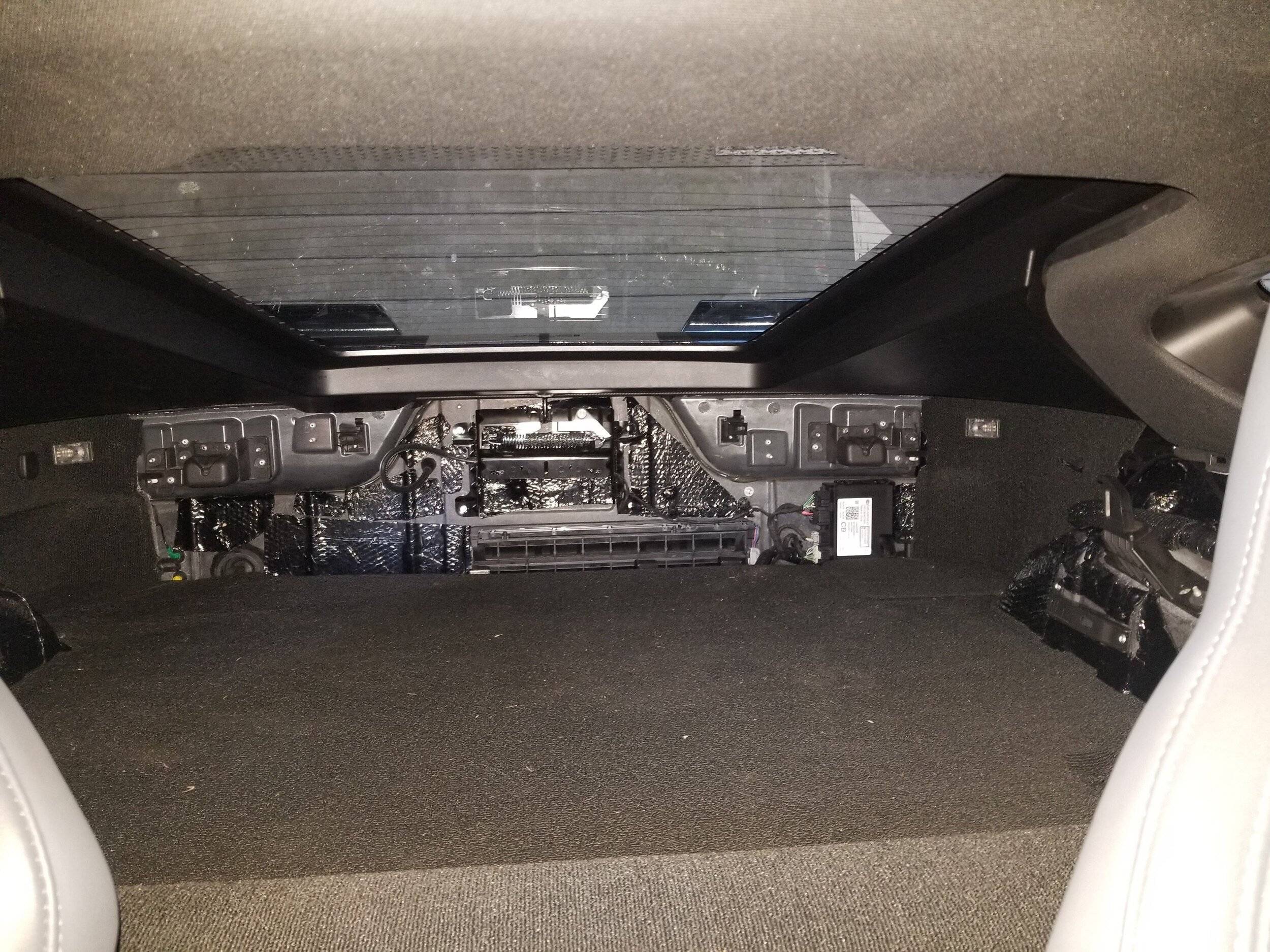

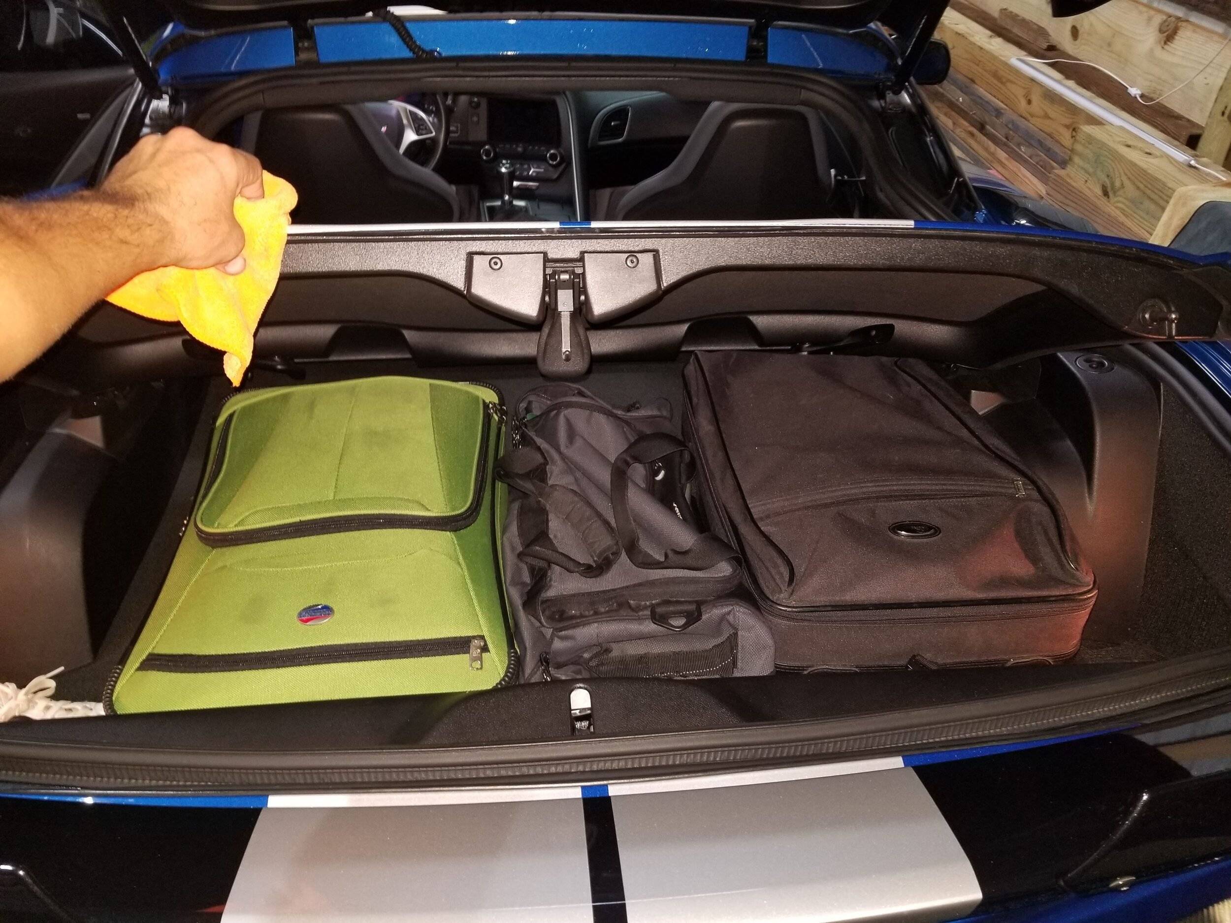

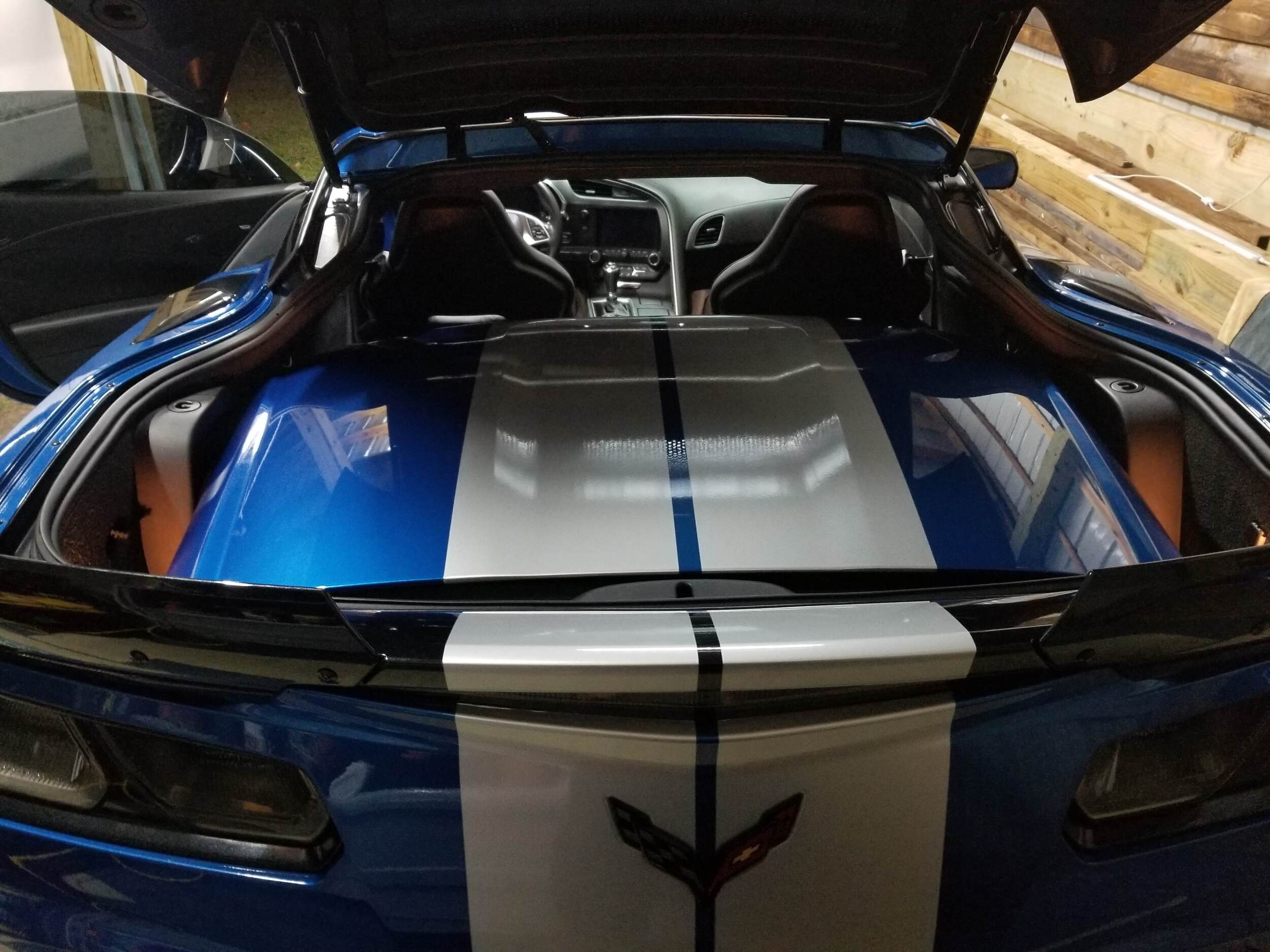

  • Max box width (driver's side to passenger side) 42".
  • Max depth from the floor to roof (with targa top stowed)
    • 6.5" at trunk lid and 8.5" behind seats
