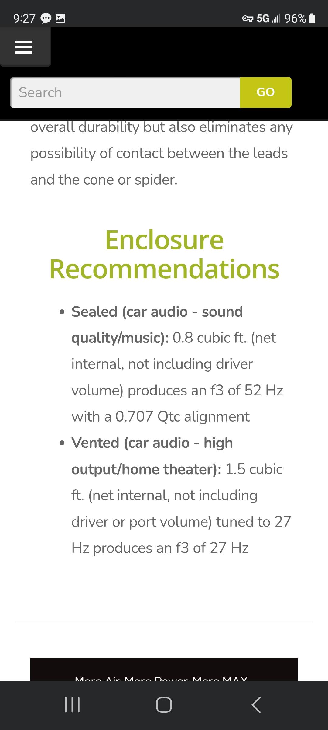

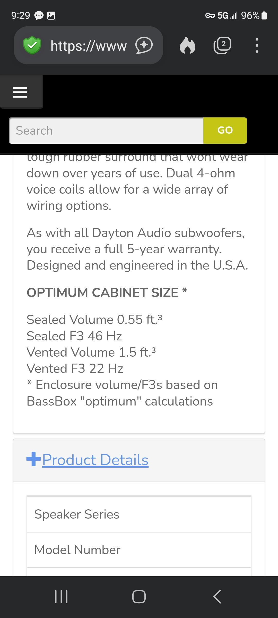

Have about 3cf net to work with
Box can go up to around 50 inches wide so port length should not be an issue
Toyota tundra gatley seat brackets
Going to use three 10 inch subs
I have three of the older dayton ultimax um1022
Or I have three of the dayton ho dvc subs
What sub option would you go with?
Also sealed vs ported?
Yes rss-265hp-44
In that case, you can run two ported or 3 sealed.
