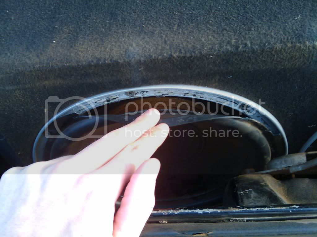

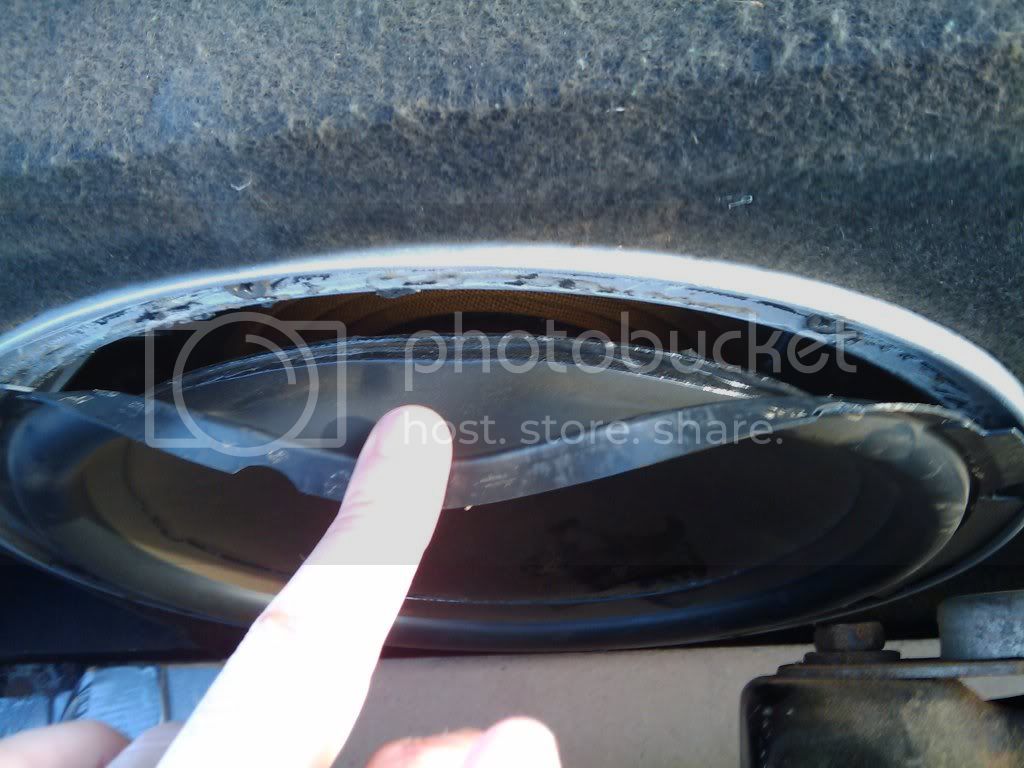

So yesterday I was bumpin and my subs were sounding wierd, as soon as I heard they werent playing right I turned them way down. I get home and find that the cone on one of my subs is comming off. Its not torn on the cone its self, but it came off the metal part somehow. Im not sure if this falls under the reconing category. But please help me out with how to fix this. Is it worth fixing? What caused this? Pics...
Yeah I thought some glue would do the trick. But what would cause this? It looks like somehow I screwed into the cone...
I got the sub used, and the guy said the sub surround came off.

easy fix here. take the sub out sand off the old glue from the basket. then skuff up the back of the rubber surrond and glue with cs(super glue). gorilla glue makes a super glue you can find at any hardware store to fix this. ca glue and rubber will hold...
2 part epoxy is your friend.....
CA glue or this
As for the cause, probably cheap manufacturing or something. I don't know what sub it is, but it was probably made in China... just go to a hobby store and pick up the most intense CA glue (super glue) they have. Or 2 part epoxy, then glue it on, then clamp the sides on. You can use bar clamps, or whatever you have laying around that'll put pressure on it. Try to make the pressure as even as possible.
I had a similar issue with my RL-p, used ca glue like everyone recommended but didnt hold long, because of the metal cone. Someone suggested Plumber's Goop and it did the trick, bonded the hell out of the sub lol and I beat on it hard lol.
