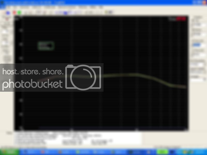

this is the response at my listening position. it's in a 3.32 cubic foot sealed box.
the low end extension is unreal. room gain FTW!

yup sealed only. if you look at the in-room response graph i posted you'd see the VERY flat and very extended frequency response.
it's perfectly flat (within 1 db) from 16hz up to 60hz. it's only down 2db at 12hz. so the F3 in room is at like 10-11hz. thats plenty low.
