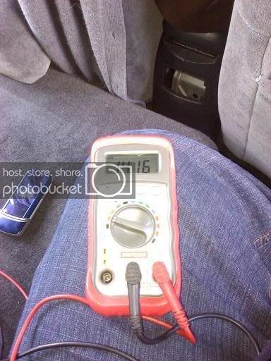

Here R my voltage readings as of 2 days ago. Idle with music off 14.16 volts

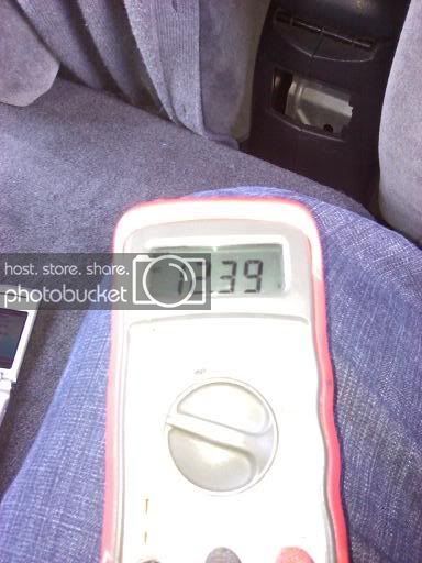

And When i was playing the song BME click by lil john at volume 46 out of 62 the voltage dropped to 12.39 and the sub was cutting out a bit but was realived after i gave it throttle to approx 2500RPM's

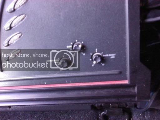

Here are the knobs of my amp Set to 38.7 volts to power my 12" L7 DVC 4ohm wired to parallel

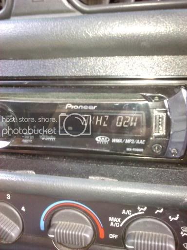

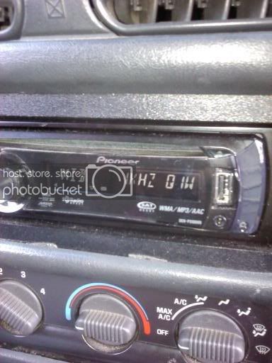

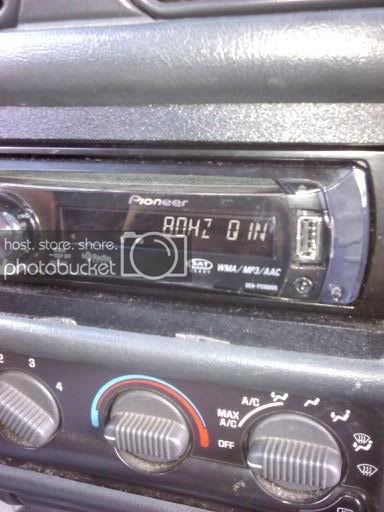

Here are the settings of my headunit, Oh and i left my preset equalizer set on flat before i made these adjustments to the stereo.

are you testing voltage at ur amp? as long as ur staying above 12volts ur amp should NOT go into protect.
ur car can skip going down the road running @ 12-12.5 volts because your fuel pump dosent get enough juice and build up enough pressure and ur coil pack voltage is low too...

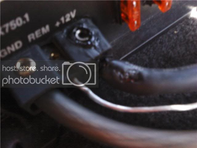

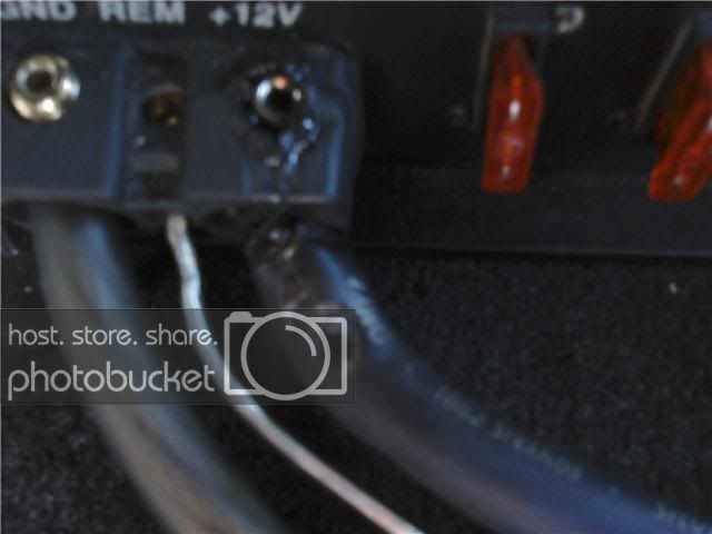

i got some good news and some bad news... So i tried my brothers sony explod 1000watt amp on my car and everthing works wel. No sound cutting off and the lowest the voltage drops to is 13.16 and i tried my 08 ZX 750.1 kickier mono amp on his car which is a honda civic and the sub cutting out problom remains. This is with the gain at 50%. The bad news is, its seems to be my amp at fault to be the problom and i no longer have warranty //content.invisioncic.com/y282845/emoticons/frown.gif.a3531fa0534503350665a1e957861287.gif But i talked to the kicker representative and to diognose the amp is 25 bucks and repairs are normally from 40-90 $ and if i get my amp repairreed whith them they will not charge me the diognose fee and only the repair fee. While i was chekin out my amp to remove it from my car to put it on my brothers car. I noticed this...
What causes this to happen?? Input is appriciated.
