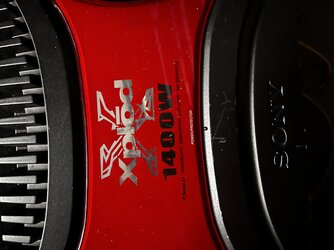

I have a Sony XM-D6000GTX amp running 2 12 inch 4ohm 500w subs. I’m very new to this and don’t know how to figure out what subs I need to run with that amp. It was wired with a line out converter off of the factory amp from the factory sub outputs. I ran 4 gauge power and ground straight to the amp from the battery with a 125 amp inline fuse. Everything worked great for about 5 minutes and then it blew the 2 fuses in the back of the amp and one of the subs was smoking. If I press the subs in, one of them moves in and out like normal but the one that started smoking doesn’t move at all. I don’t think it was a wiring issue, more so just the amp possibly overpowering the subs. Can someone please help me find what subs would work with this amp or why that it may have blown?

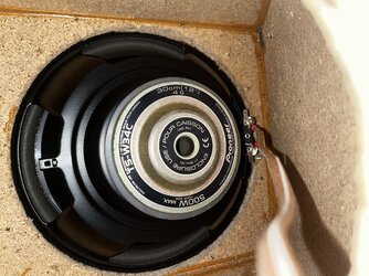

You've toasted one of the woofers for sure and sounds like maybe the amp too. The site is having issues with pictures, can't see specifics. Which Pioneer woofers and how did you have them wired up to the amplifier?

TS-W34C is the part number on the subs. I just had the power ran to the power output on the sub and ground wired to ground output on the sub, left sub hooked to left output, right hooked to right. Amp says it’s good for 300w at 4ohms and the subs were rated at 500w 4ohm so I don’t see a problem there. Possibly just because the subs are like 20 years old? Lol

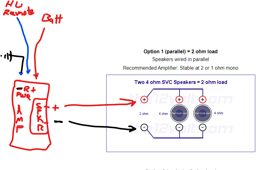

??? You mean +/- on the speaker output from the amp to the +/- on the speaker right? You indicate that there were two subs so they should have been wired like this:
That would create a 2 ohm load to the amplifier and that amp puts out 600 watts RMS at 2 ohms. Those subs are rated for 150 watts RMS and would have split that output so possibly 300 a piece, twice their RMS limit. That usually blows speakers, not amps, except when you fried the first one, it would have shorted the circuit causing the amplifier to blow it's fuses.

I agree with Doxuzme. It sounds like you wired to 2 ohms which isn't a problem.
Do you know how to use the 'gain' knob on the amplifier? If it was turned up too high, it's easier for you to blow your subs up.
How loud did you have it when it died? Were you pushing them hard?
Your description of the damage sounds like a fried voice coil in the sub. Hopefully others here can confirm or deny that thought.
You don't have the wrong subs, you might have just mistreated them. I recommend trying to do a little research. Learn about car audio a little bit, or take your car to a shop and have them help you out.

I had them wired exactly like that. Amp turns on and works with the remaining sub. These came out of a car my friend bought but he didn’t use them so I just put them in. Quite possible that the one sub was already hurt. Thank you for your help. I will be buying one new sub and hopefully all goes well.

I had every dial on the amp all the way down any the volume was not loud at all (was having a conversation in the car when it blew) After talking with some friends who know more about this stuff and checking the wires, we determined that the one sub was probably already messed up when I put it in and it just took a minute for it to get warm and possible short within the sub. (We are guessing that these subs are like 20 years old considering that the car they came from hadn’t even been registered since 2007 before my friend bought it.) thank you for your help. I will be buying a new sub and hopefully all goes well moving forward.
