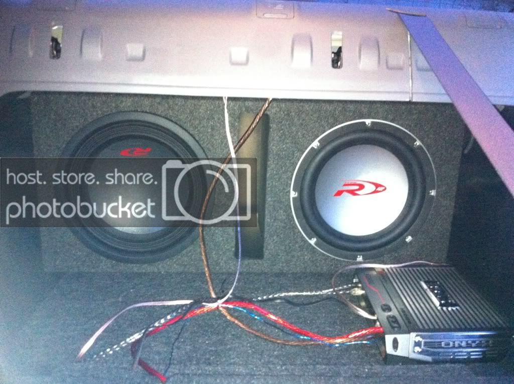

It is most likely the subwoofer that needs replacing/exchanging but could you take some more pics of the setup? I really want to get a grasp of everything you are running. I am under the impression that you are running 2 different model subwoofers.
I meant to get a new amp not sub sorry. Two subs, new model and old model, both Alpine 1243D. The guy said the new sub I bought was not having this issue with his amp. Sorry, at working trying to do too many things at once. New one is on the left, old one on the right. Yes the new one is upside down, didn't realize it until after i put it in. Yes it's very unprofessional, but it was a quick setup to test if it worked.

don't worry about the install just yet, it isn't much of a problem. Alright one problem I can see besides the amp *******, Is that both of those subs are not divided because it is a ported box. This can cause a lot of issue if the subs are moving a lot. First of all, the new one is probably tighter. They are both entirely different subs with different internal parts/designs and different specs. You are going to get cancellation from both subs sharing an enclosure and but not moving exactly the same. This could potentially cause premature wear/damage to them if they are being pushed hard. 2nd problem is that with all of the clipping that you are most likely getting from the amp, you could have damaged the new one which would have a tight suspension and wouldn't be worn in. This could tear softparts and cause that rattling. What you should do now is take the new subwoofer out of the box and visually inspect the inside of the sub where the cone meets the spider. move the cone outward with your fingers pushing against the inside of the cone to inspect it.
They will "work" but won't perform optimally. They don't have the same T/S parameters so they will try to do different things at the same time and make eachother suffer. You should never mix equipment. Always use matching speakers if they are geared for a single purpose.
