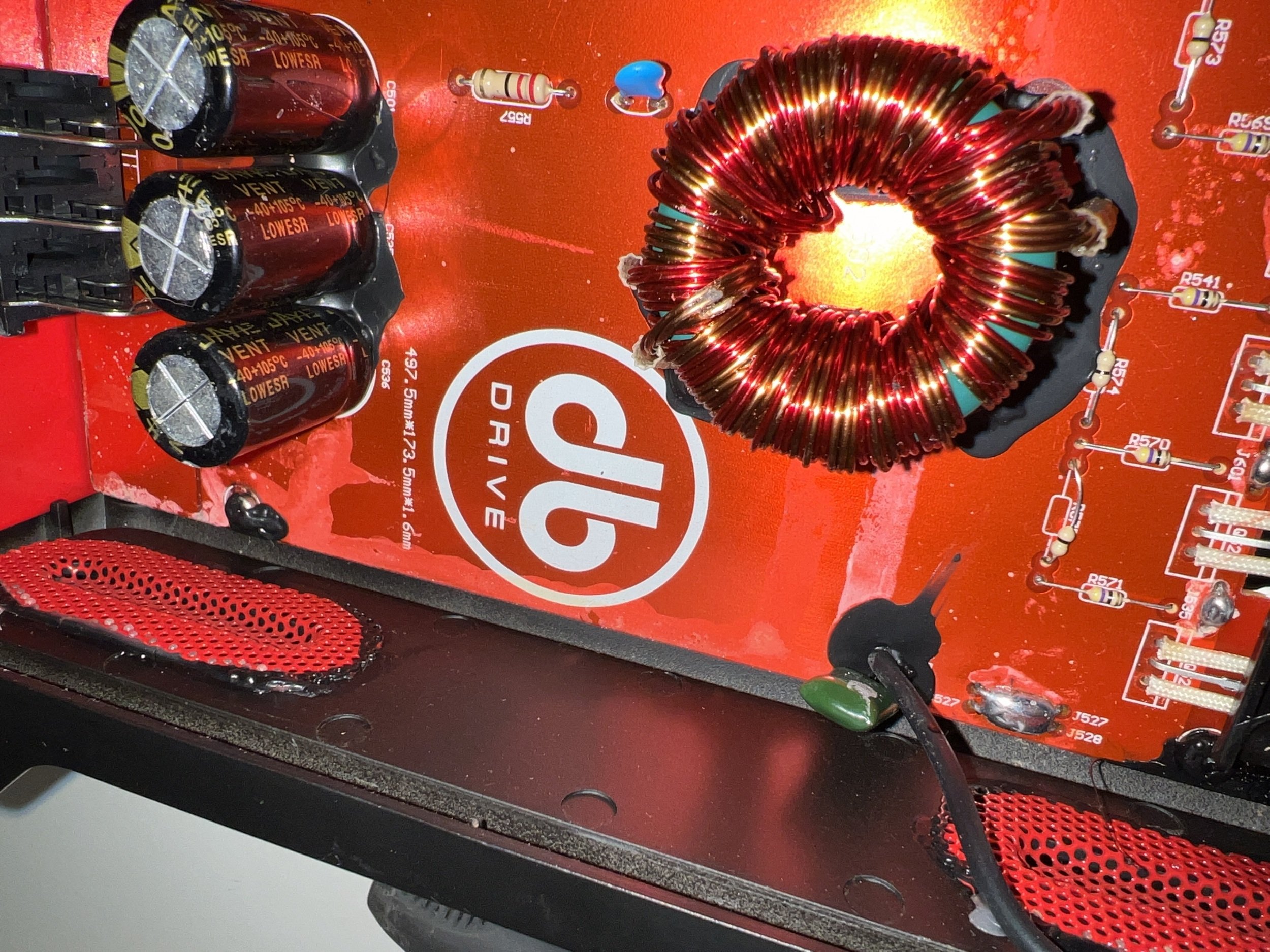

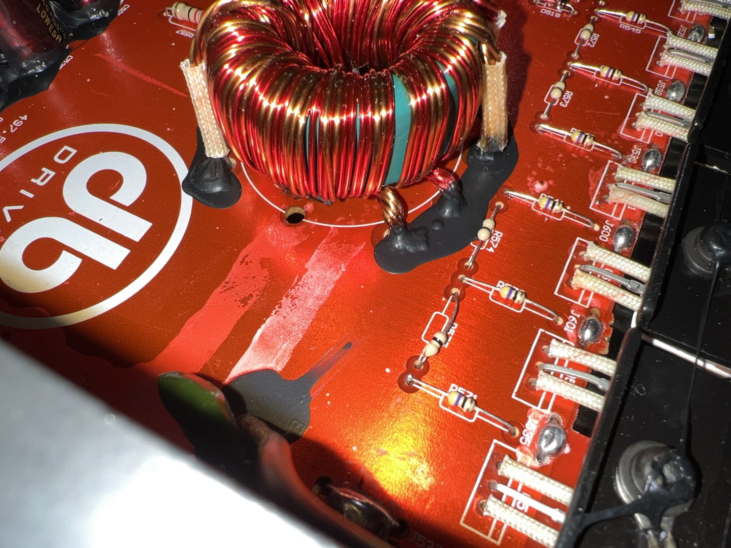

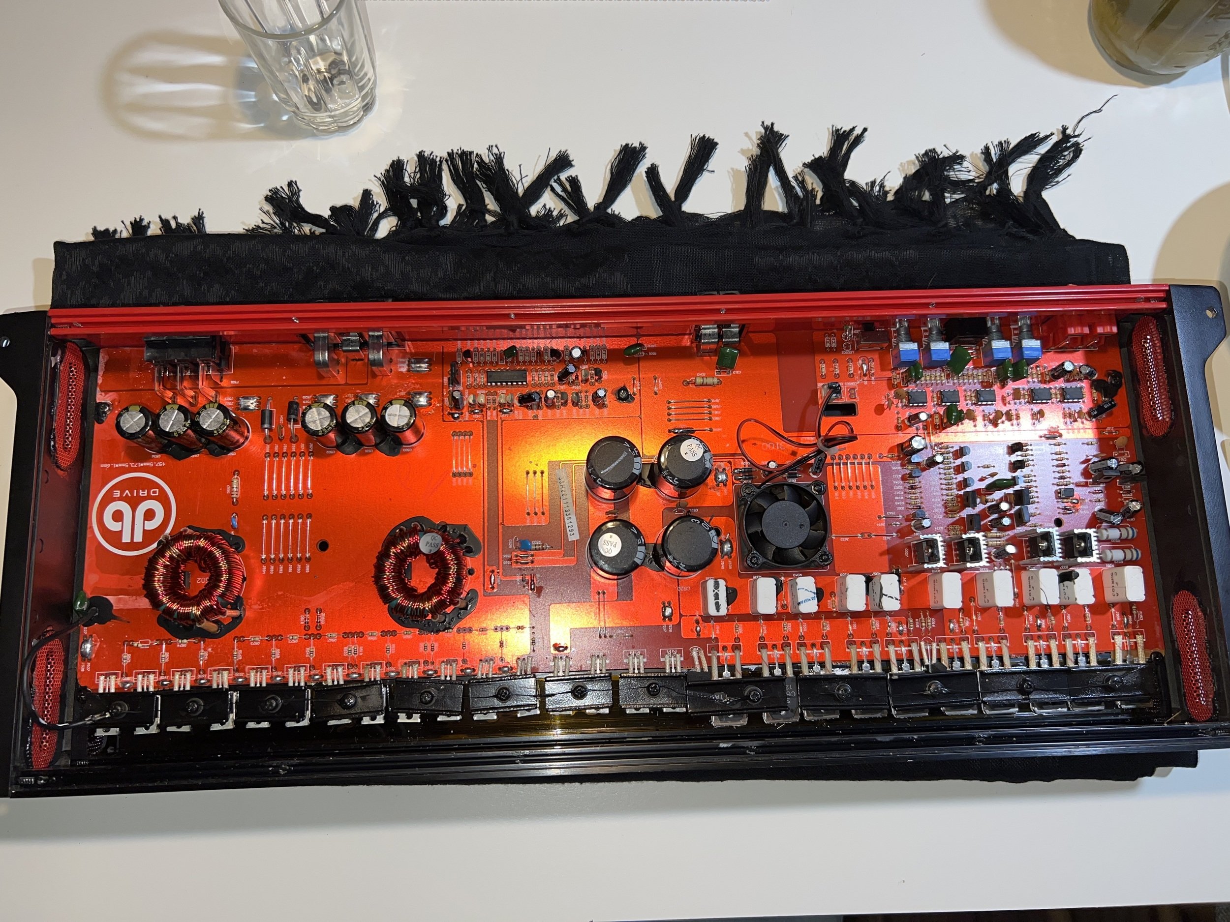

Seems as though I may have found some water damage after pulling the amp apart? At least it seems like moisture got in there.

What are the chances that it could be anything else under the sun, lol?
You're certainly ruling stuff out here. I'd say if the ground from amp to chasis is sound and you're not experiencing trouble with the other amp nor any other of the car's accessories/electrical there's not much left besides the sub amp and perhaps signal cable running to that.
That may be just some residue from something done during manufacturing. While it's open you might see if any of the larger components feel loose or appear broken at the land, otherwise there's not much that's really user serviceable for a layman in there.
Maybe so, I'm certainly no technician. I did read that, it does not hurt to clean it up a little bit with Q-tips and isopropyl alcohol, very lightly. I went ahead and cleaned it, there was certainly some corrosion on some of the components inside the amp. Not banking on that, but, I figured it wouldn't hurt. Now, as far as that signal cable, what would cause that to create the noises I'm hearing? I'm asking out of curiosity of course. The signal wire is spliced to reach the amp, because at one time it got pulled out, and was too short to go back into its rightful position. I'm running an 18 ga wire as a jumper from the speaker amp to the sub amp. It does show 14.xx volts but, I'm wondering now if that splice isn't creating issues?
So, to follow up, I got everything working properly again. If you refer to the photos I sent of the amp internals, you can see there is that white residue. What I didn’t get the chance to get a photo of was the bottom side of the board, which had some mild corrosion as well. I cleaned the board very carefully with q-tips and isopropyl alcohol, and every single contact. This was a two hour process, but once I finished up, I allowed everything to completely evaporate overnight. Put everything back together, and boom, it’s operating normally again. I hope this helps anyone facing a similar problem as me, but do it at your own risk. If done improperly, you can permanently damage a board that may not even have issues. Thank you guys for the help!
