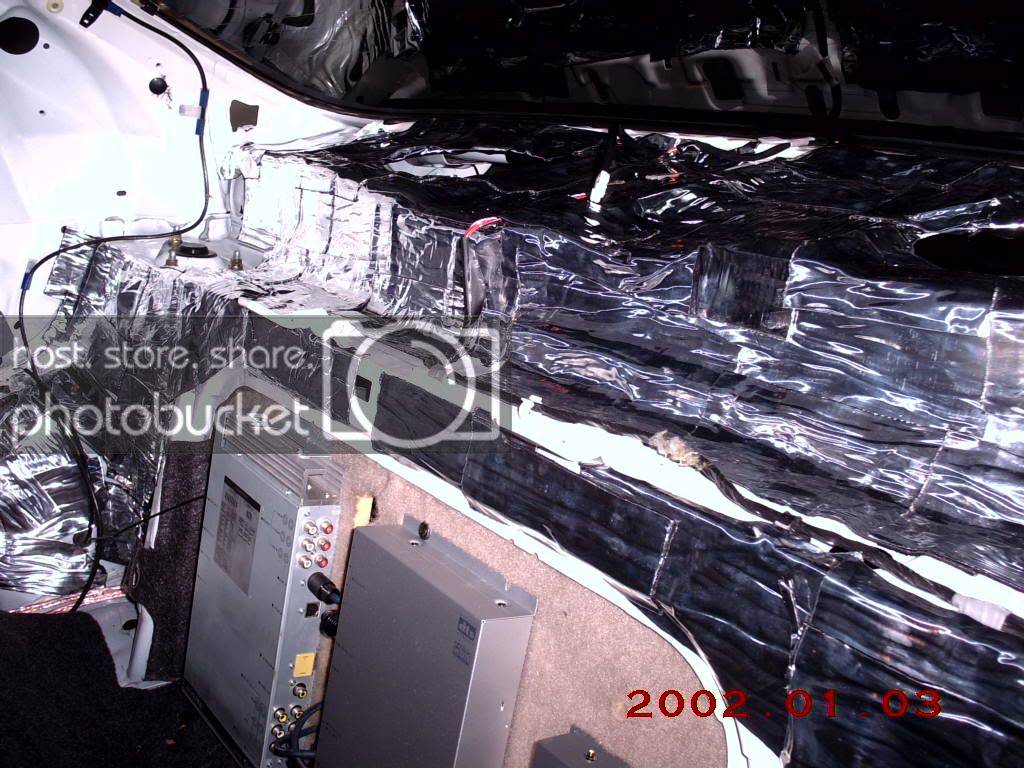

How many layers of deadener do you have? More is always useful //content.invisioncic.com/y282845/emoticons/smile.gif.1ebc41e1811405b213edfc4622c41e27.gif
You're going to have to build out the speaker baffle with something, but that looks like a good start.
Also, how did you cover those large open holes? Just putting deadener over them? A better way, if you could fit the pieces in, would be to take 1/8" Lexan panels and cut them to fit...I did something like this for the large holes in my door, CA'ing them to the metal and then deadening over that. Remember, you're trying to make your entire door a giant sealed enclosure, and it needs to be as airtight and acoustically dead as you can get it.

Last time I talked to him he was doing his doors like mine...deadener, liquid, then rattle pad. No need for plexi, works fabously.

thank You //content.invisioncic.com/y282845/emoticons/smile.gif.1ebc41e1811405b213edfc4622c41e27.gif i will to get it right. i wont use liquid just yet will try with out but i will use rattle pad. i have 3 in hte inner layer.. and 2 on the outer layer of the door.

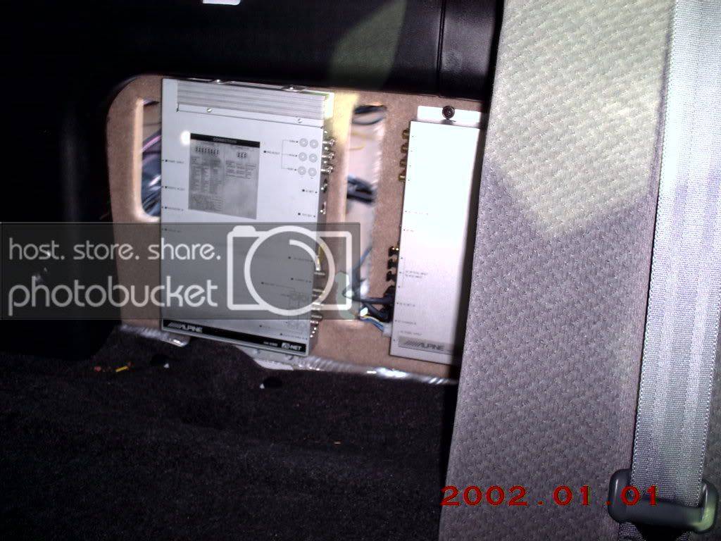

yup gona runn a RAA1000 for a IDMAX 12, and RAA4200 for the 2 pairs of MB Quart Q's with a H700 but a H701controller and a D300 screen //content.invisioncic.com/y282845/emoticons/smile.gif.1ebc41e1811405b213edfc4622c41e27.gif
