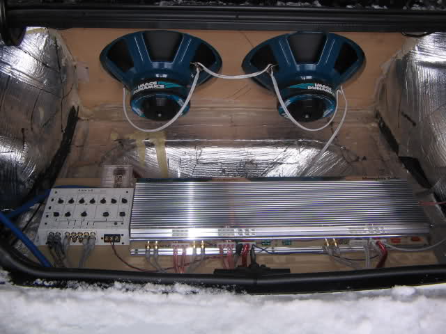

i went from sealed to ported to sealed to infinite baffle.
pair of idq15's for the win.
i like infinite baffle the best.
lol. hey dave. ibftw.

the only problem with IB imo is that you sacrifice volume. so in order to make up for that, i doubled my cone area.
the asskicking heartstopping bass is NOT there if thats what you mean. its still ****in loud. i did a 139 on the TL with my IDQ's IB with 600w.
so its not quiet. but there are setups that can get a lot louder, but not many can sound better imo.
