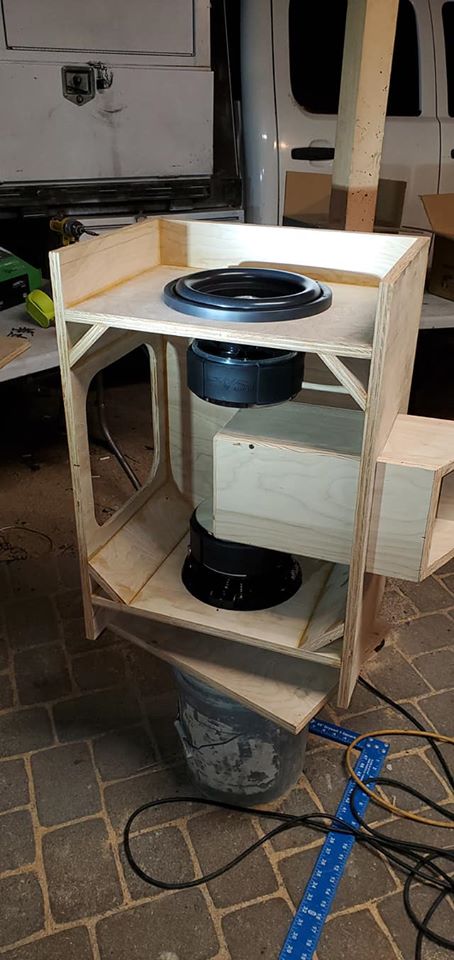

A 4th order bandpass for a single 8" sub need not be too large, granted the one pictured below is a lower power one but having a 4th with the port positioned in the Skipass with the remainder of the opening sealed off is usually how its done for most Bmw in my exp... and it works well.
That ^^^^ ain't too large imo, and should reinforce the lower frequencies pretty good with a lower powered setup.
Working on a 4th order for an 8 now with the port on the outside of the box. A 4 inch circle into the cab is all you would need.
