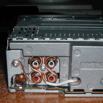

I had a similar problem with my 4 channel when i first installed it. Static in speakers and got louder with volume. I grounded the RCA's on the back of the HU. I believe the real probelm was have the HPF/LPF set on the amp. Set it to full and set filters on the HU. Could be your gain is also to high
Interesting you say this! How would one go about grounding the rca cables to the HU? Maybe dumb question but I dont know how personally. Also I will try what you said with the filters! The headunit has easy enough to use crossovers i believe
