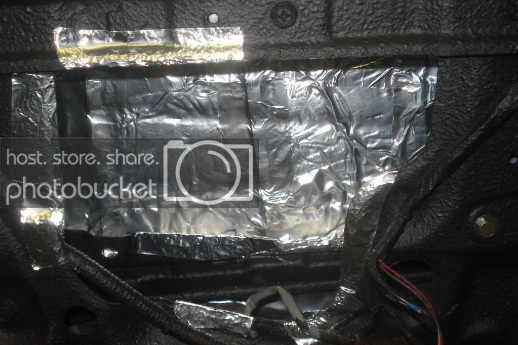

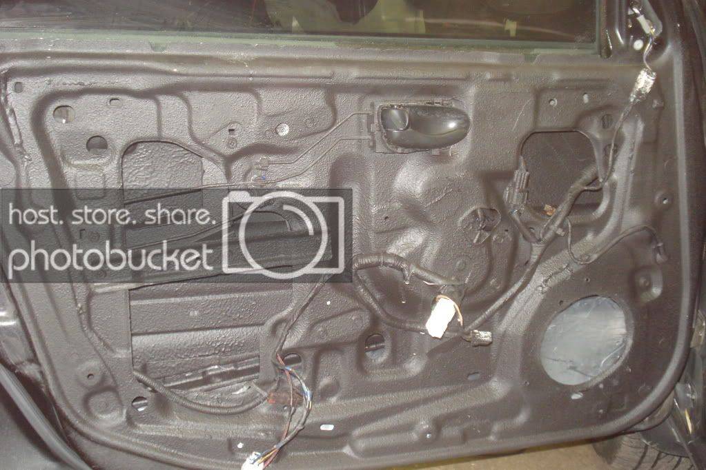

this is of the drivers side door. you can see the spectrum sprayed on and if you look to the bottom right, you can see i started the CLD tiles.

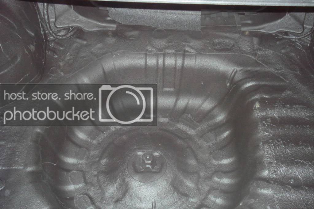

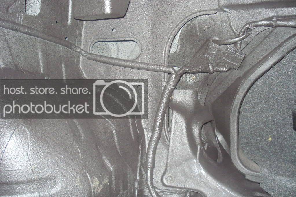

this one is a shot of the trunk after 2 THICK coats of spectrum.

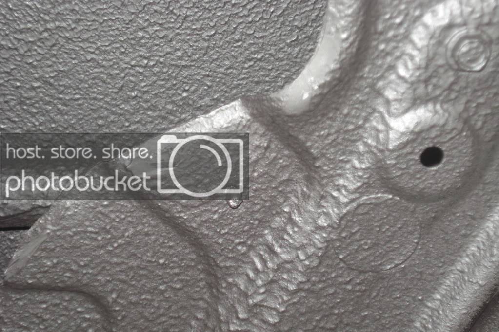

close up of inside trunk.

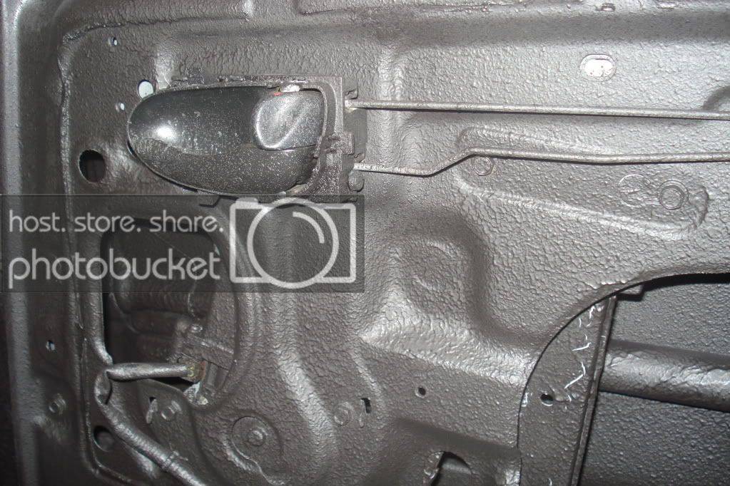

this is a close up of the passenger side door.

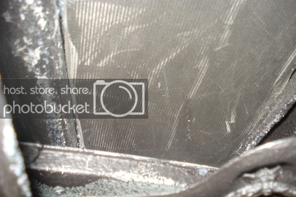

this is another photo of the drivers door with spectrum sprayed on.

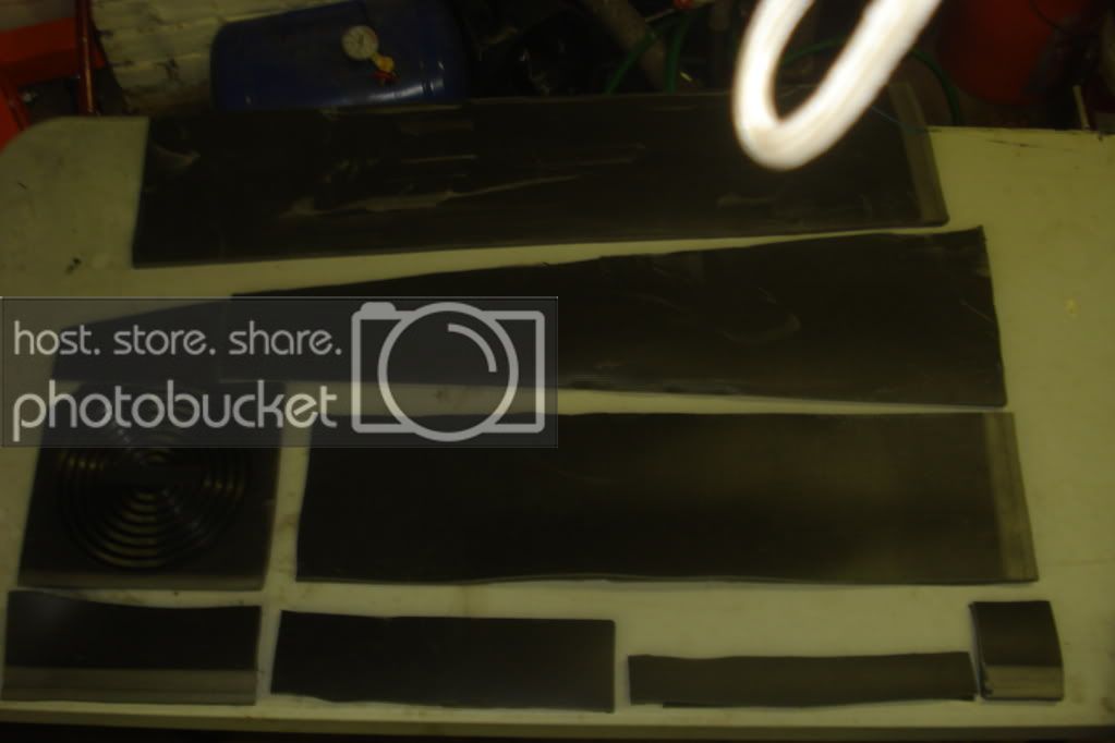

here is a photo of the cuts i had to make for the passenger side door. notice on the bottom left that i did purchase the speaker tweaker kit.

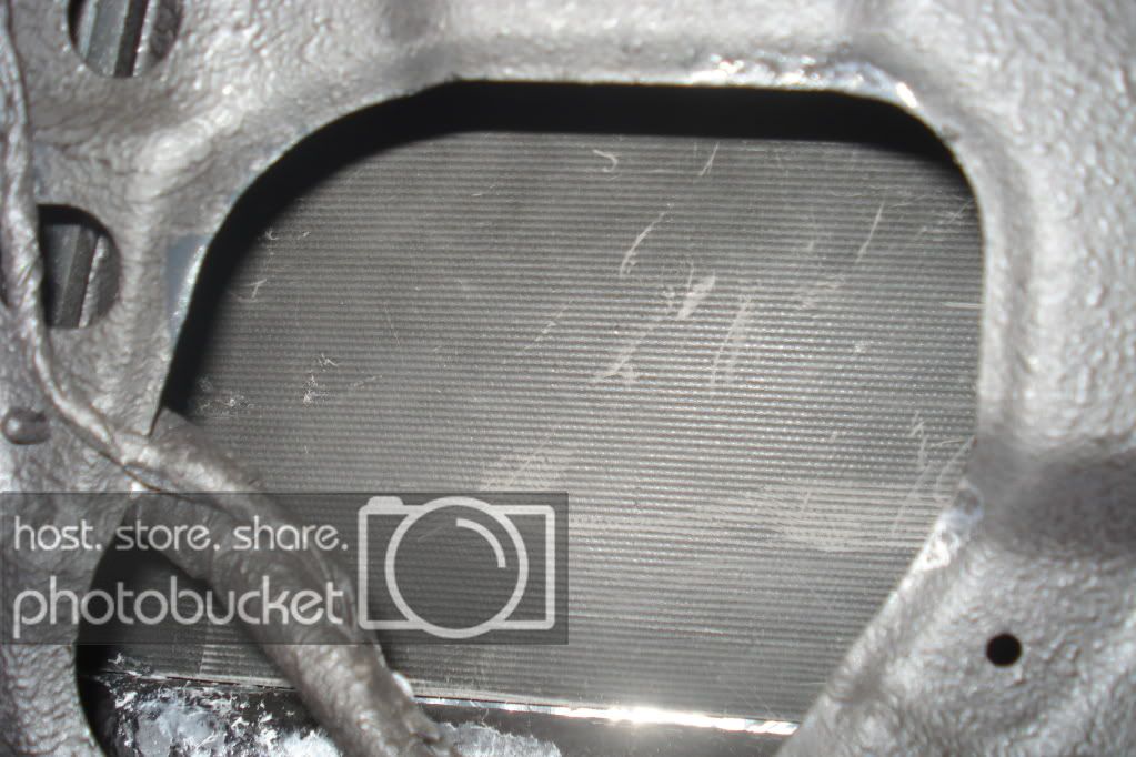

this photo is a shot inside the door with the MLV that i cut fit and glued into place.
here is a picture of the door with the spectrum and mass loaded vinyl glued inside the door.

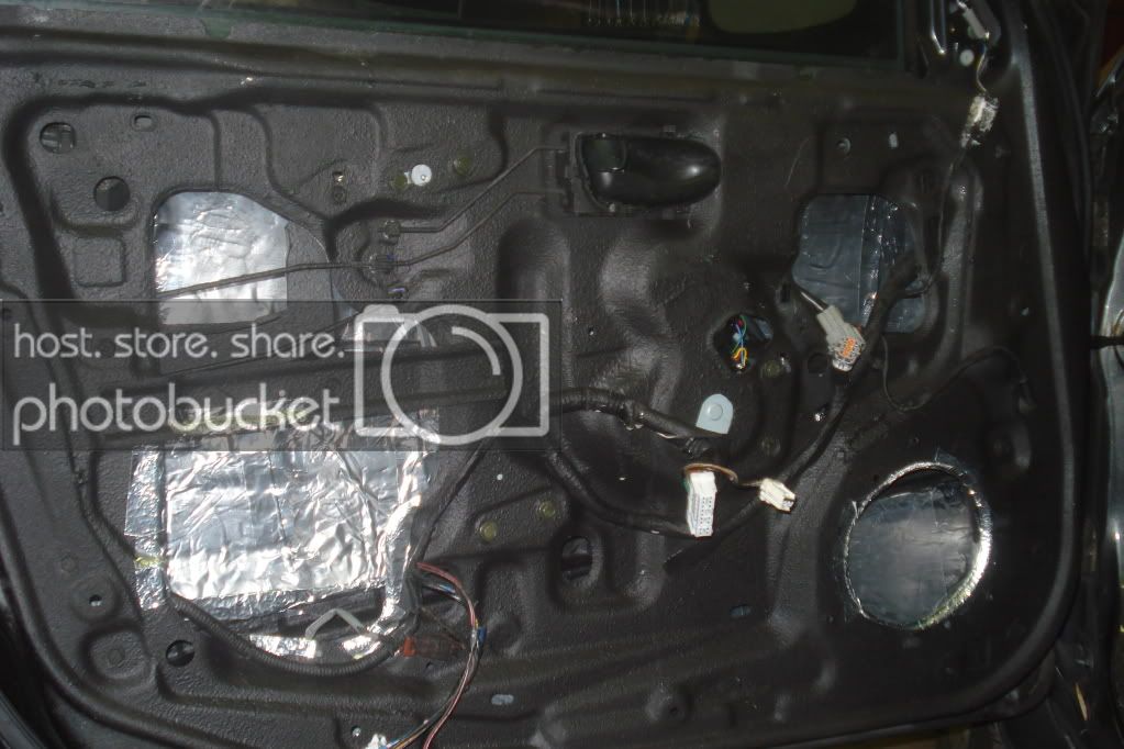

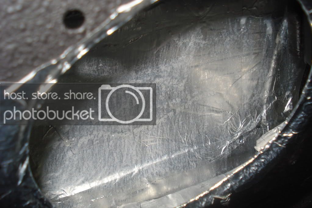

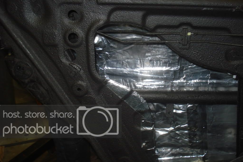

so yesterday i did a lot of work on the vehicle.
this is inside area of drivers door.

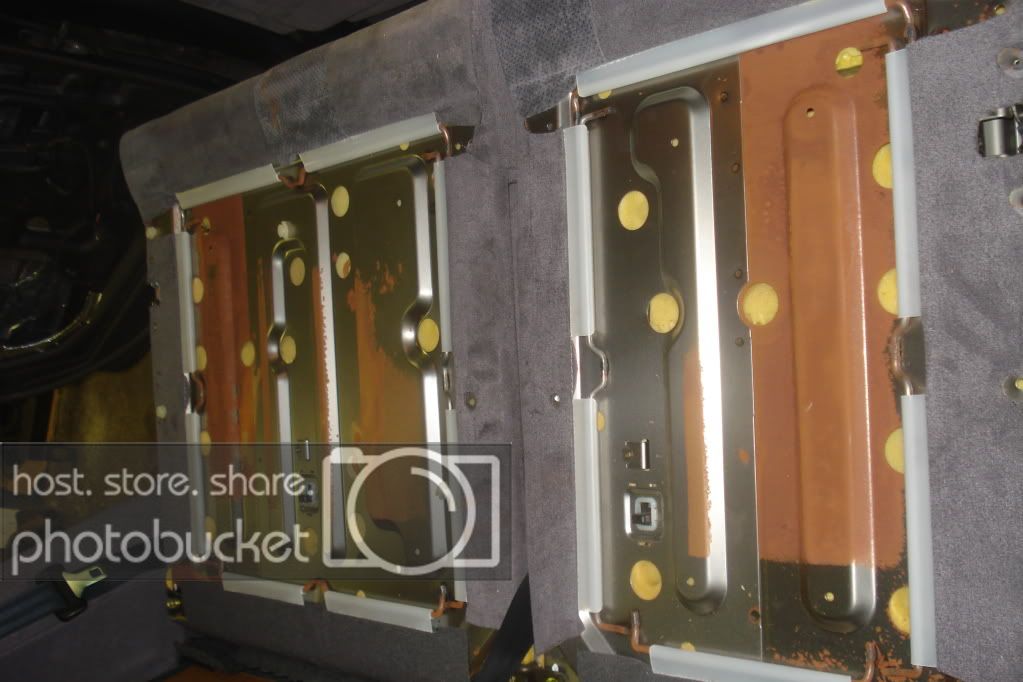

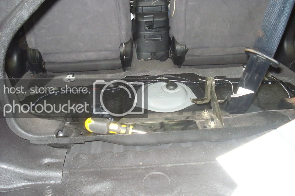

so i decided to also rip my back seats out at about 10:30 last night because of this rust that was forming on them and i am deadening them anyways. i am going to paint some spectrum on the metal parts and tile. you can see all the rust in this photo.
view from trunk with no back seat installed.
one of the snags i ran into was that i removed some of the spectrum from the drivers side window prior to putting in tiles. DOH! obviously they did not stick well and they pulled all of the spectrum off when i took them out. //content.invisioncic.com/y282845/emoticons/frown.gif.a3531fa0534503350665a1e957861287.gif it was only a small area on the bottom of the door, but it still *****. i did not respray that spot.
