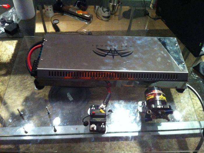

Here is a picture of the WetSound Pro 485 speakers, batteries, an old JL J2 360.2 Amp, 200 amp isolator.

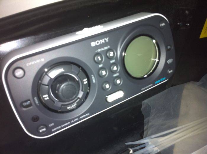

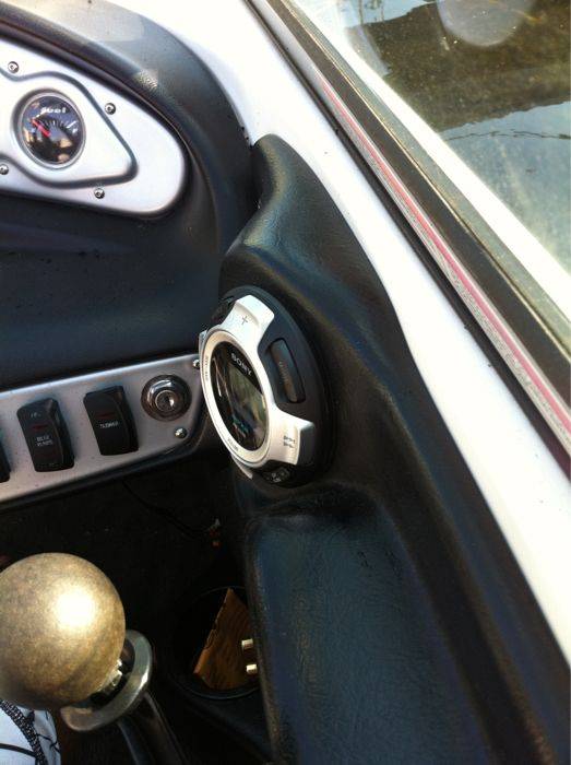

First we had to install the CD players, and driver side remote. The Cd player goes into the glove box, and the remote got mounted right by the throttle. Some dremel action and it was pretty straight forward.

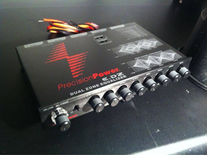

The PPI E.DZ comes today so I will be installing that later this week once I figure out the SA10 install.

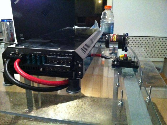

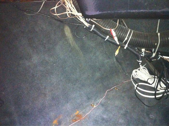

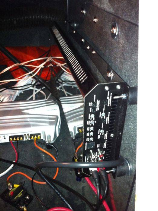

The second issue was figuring out how to mount all the amps. The boat's hull is fiberglass, but not thick enough where you can screw in amps. There is a compartment that is somewhat protected from the elements where the battery and amp will go. So First thing was to build a plexiglass amp rack that would hold the WetSound Syn6, breakers, and Isolator.
Luckily the right side of this compartment had "Starboard" aka marine plywood glassed into the hull, so we could screw the over sized board directly into it. (Don't mine the sony amp and wiring, we were just testing)...

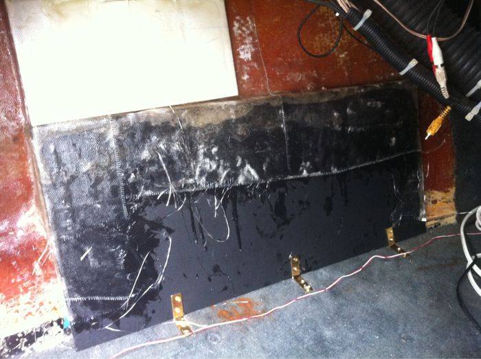

next up was how to mount the other 2 amps.

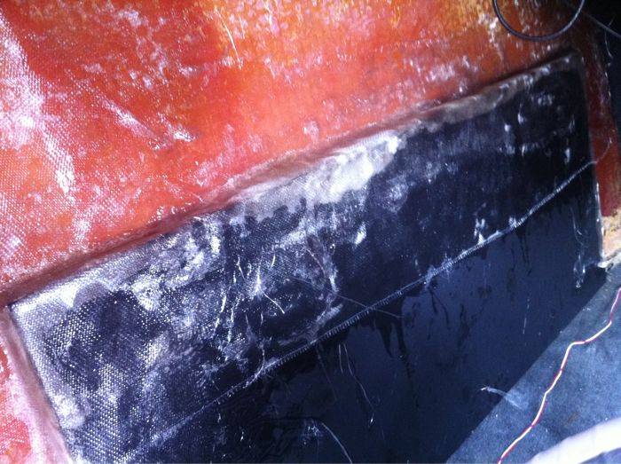

Solution, fiberglass more of this marine plywood to the left side of this compartment, and re-carpet it.
I have never used fiberglass mat or epoxy before so don't be too harsh, it looks great once coverd =P
Took the carpet off, and there is the hull. Let hope we don't drill through it!
1st layer of mat and fiberglass
Couple more layers and got some L brackets to hold the bottom in place. Also fiberglassed a smaller piece above it to mount the distribution blocks.
Voila! Carpet covered and looks pretty decent!
Mounted the 2 other amps (Audio Pipe one still has not been ordered as im still trying to figure out the SA10 install)

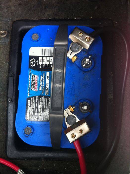

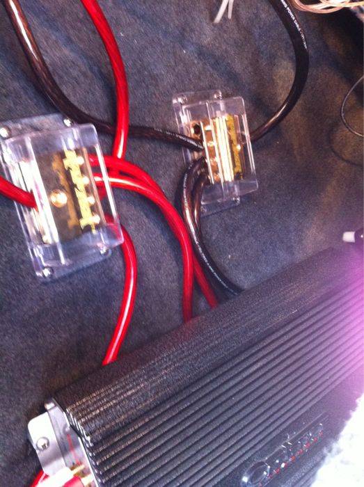

Picked up some nicer battery terminals to clean up the batteries
Some distribution blocks to also clean up the wiring.

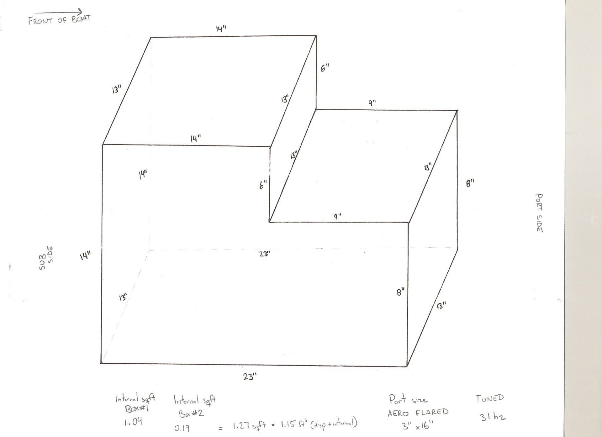

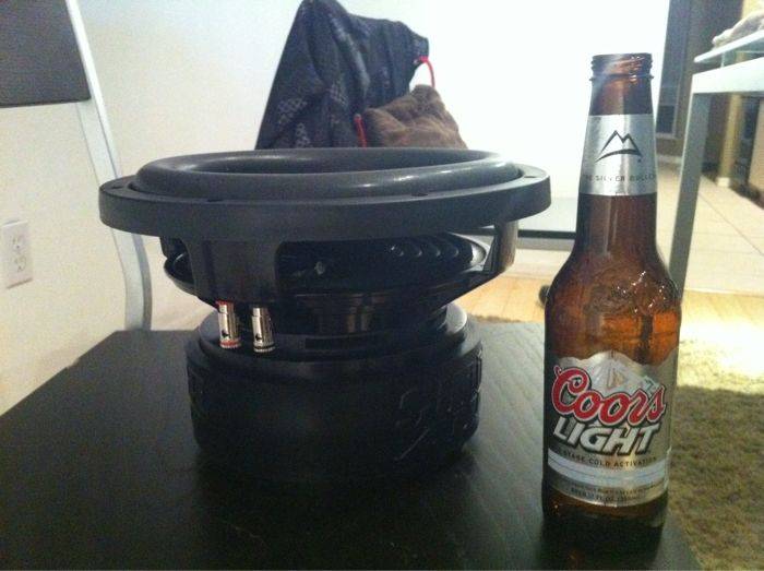

Just curious if you already have an SA-10? Cus they're not really known for performing well in sealed enclosures, let alone small ones. Just something to think about if you still have the choice. I'm sure it'll have enough output and I guess you're not really looking for an SQ boat install:p
My uncle's stock boat stereo was pretty loud, I can only imagine how much louder it is with everything you've added.
yea, I jumped the gun and bought an SA10. Sundown says .55 cubic ft will work on that sub though. Its going to be right under the drivers feet basically, so even on only ~400watts it should be ok.
Ive put a post up to trade for a SA8 since i might be able to make that fit easier.
If it doesnt work, ill be putting it in a vented box and into my truck again =P
Some more stuff came in yesterday:
Sundown Audio SA10:
And I finished the rough drawing of the box...
Will be about 1.15ft^3 after displacement and port tuned to 31hz with 3"x16" aero port

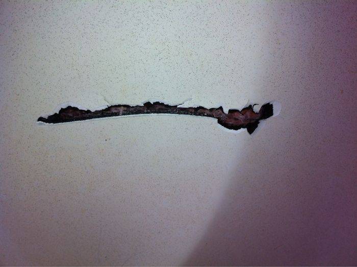

Also ran into some problems with the boat...
Seems like one of the blade of the prop decided to fly off and hit my hull!
Boo!
