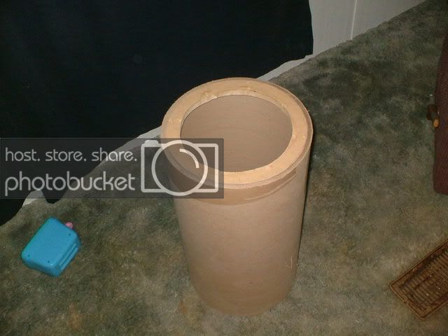

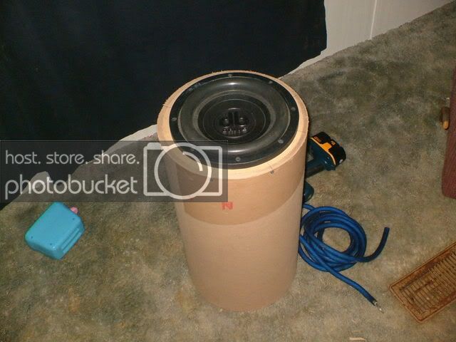

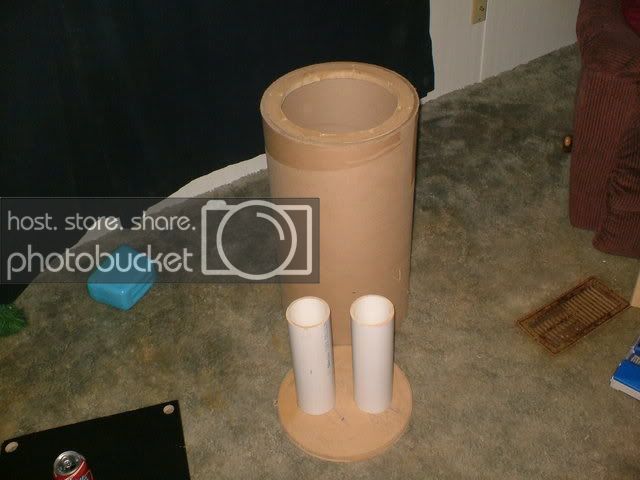

Sonotube build - JL 13W3v3, suspended in trunk
True to the flex, but it IS a round enclosure and the general nature of that shape will not allow much if any flex unless it is strong enough to actually start to break the tube itself, just like a gas cylinder or the like, round is the strongest shape for pressure. Those tubes are really pretty robust as well...Cool Idea, I actually thought about trying that a month or so ago..
^ Yes, but there is a lot of pressure inside of a sub enclosure and you dont want the walls of the enclosure to distort.
No matter how you look at it that is a cardboard sub box. Not to mention it is barely being held on by a pair of wood screws going through some sheet metal....
Im not trying to hate on the OP's stuff here, but Ive used those tubes before and I would never consider using one as an enclosure unless it was reinforced.
Did something similar. 13" outside diam cardboard tube and 12" inside. Made it for a 10" sub and tuned it to 30 hz. Tubes I get free from my job.
I expiremented with the flex issue by using multiple ratchet straps around the outside of the tube and had no gain. We are also talking about a tube with a thickness of 1/2" compared to one with 1/8".
Sry if I thread jacked.
Also a good way to keep the tubes in place. Can also make half round brackets with straps. Works well as another means for keeping in place.
Looks like a good build. //content.invisioncic.com/y282845/emoticons/smile.gif.1ebc41e1811405b213edfc4622c41e27.gif
Looks good but that cant be very strong, the walls of that tube are cardboard and there isnt any fiberglass in there to reinforce it.
No need for that. Since you are dealing with a circular form, vibrations are spread evenly around the circle and because it's a circle there is no expansion.
the only thing im worried about if I were to do this, is if my baffle or end cap were even just a little bit off there would be a leak. Plus I don't have a router so if I used a jig saw i'd have to make a perfect cut.
Take your time using the jigsaw and you will be fine. Use silicone to seal the enclosure.
