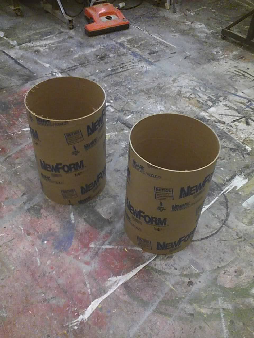

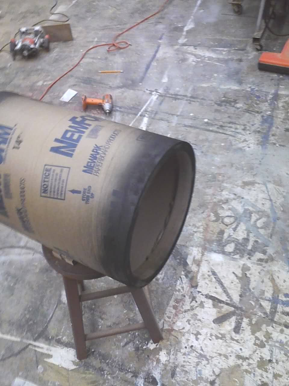

The tubes (The guy gave me two of them in case I messed up haha) 14" x 22" sonotubes.

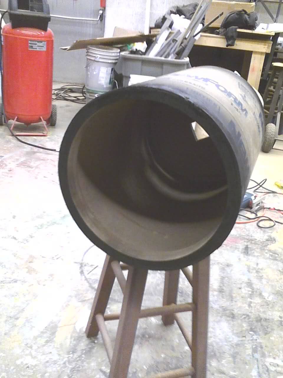

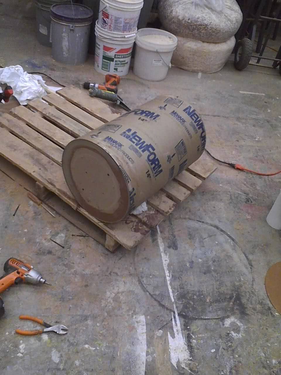

End baffles installed. The speaker is double baffled.

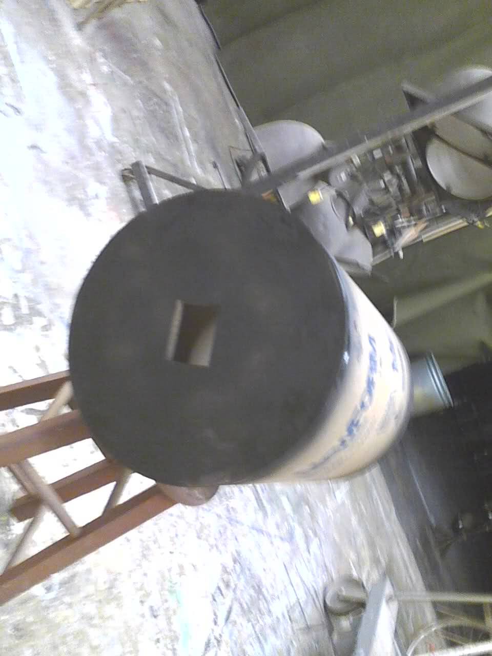

Mounting hole cut & ends spray painted black

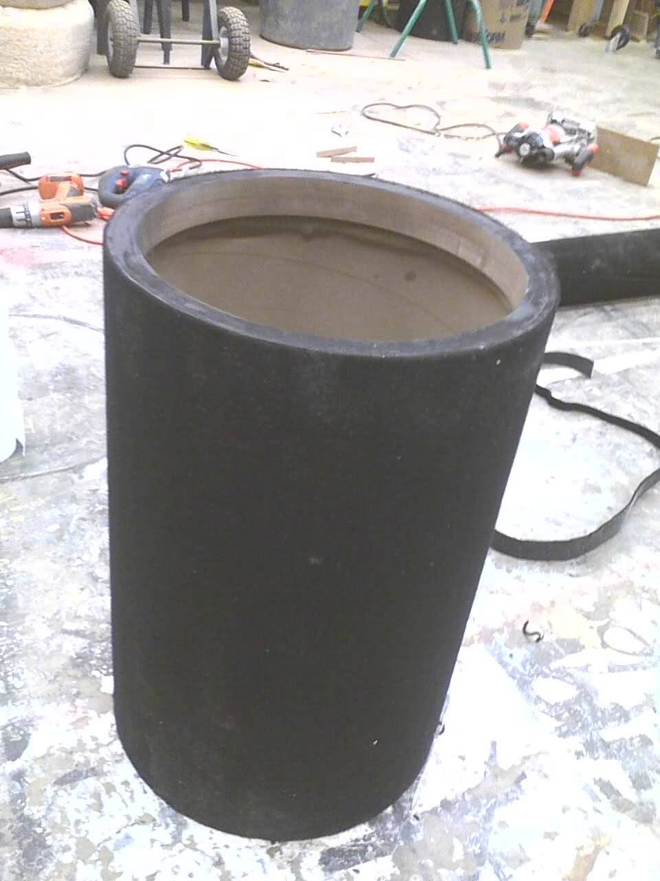

Back of tube, terminal cup goes here
Another shot of the inside

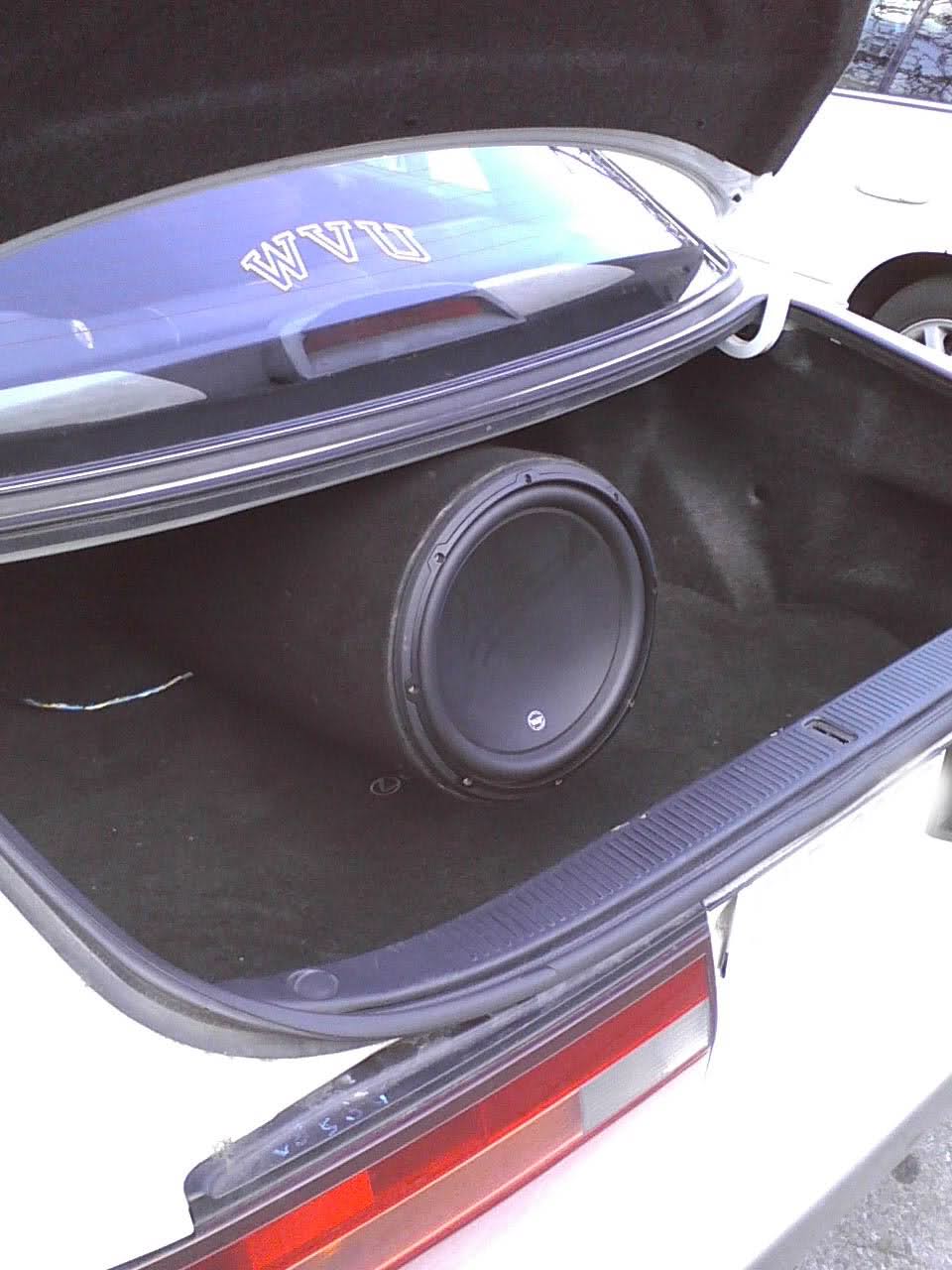

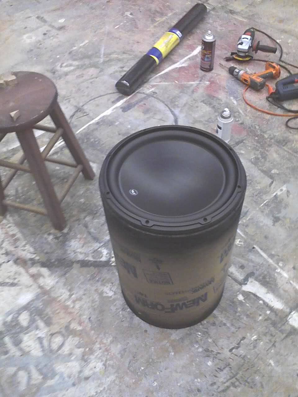

Test fit of the speaker, it's a perfect fit

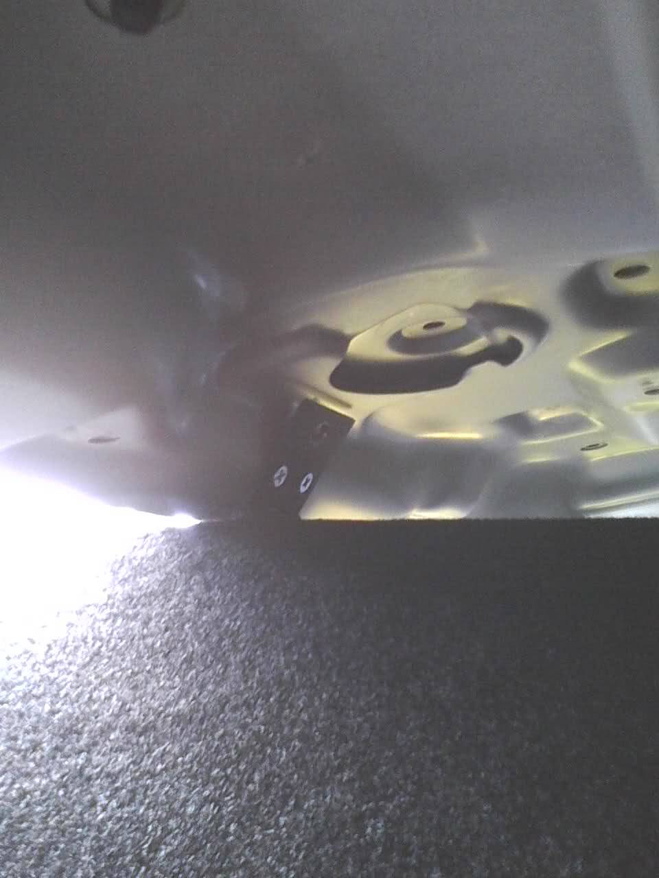

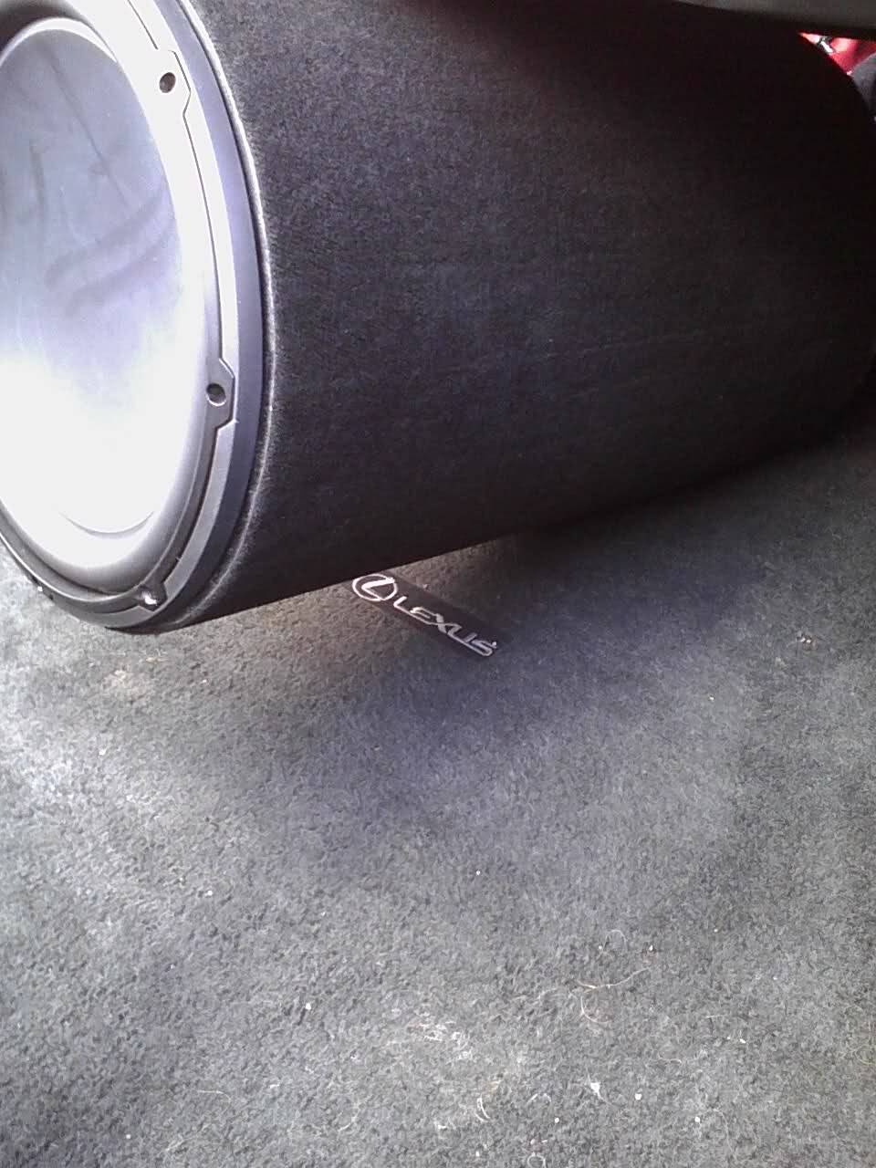

Mounted to rear deck with a hinge thing I found (Also one on back of tube for strength)

looks good. i'm interested in seeing how it holds up to hard cornering. it might wanna swing and pull bolts out. you put any fiberglass resin in there too? i might have to try something like this,

i think i might do this for a ht setup with 1 10." hows it compare to a normal sealed enclosure?
Seems like the sound is smoother through the lower frequencies... Not sure exactly how to describe it other than smooth. Like it's punchy and tight like a normal sealed box, but it just sounds nicer. This is all IMO obviously. Try it for yourself - for like $25 bucks you really can't lose.
No resin in this one. If it breaks, I'll make another with my spare sonotube and resin it, and find a more solid way of suspending it. I'll keep you posted.
