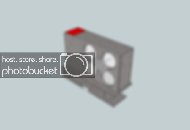

okay so the 4 skars will eventually be reality //content.invisioncic.com/y282845/emoticons/smile.gif.1ebc41e1811405b213edfc4622c41e27.gif Got a Powerbass XA3000D. i was reading how they really hat vibration. mounting onto the box was NOT an option at all. Not worth it to me. so i drew up a new design. went with a fairly larger enclosure to reduce the spike before the cutoff. 4.75ft^3 @ 30hz Box will have quite an organic flush mount kind of look to it. should be killer once all said and done. also .5" all thread will be used for bracing to reduce and possibility of flex on the lower notes. Due to space restrictions in an extended cab Im going with a custom shelving unit under the the box that is a separate unit secured by the OEM jumpseat bolt locations-8 total. I do not want this moving around haha.
here is the exact sketchup model to spec
notice the small gap on the left, that is for my jack tire iron etc. above that is where the powerbass will be. to the right of the hump cutout will be the deka group 31, then the space on the far right is where the rockford 2ch will go.

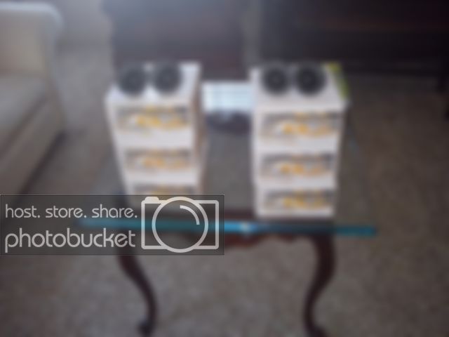

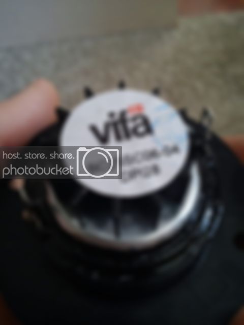

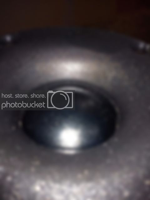

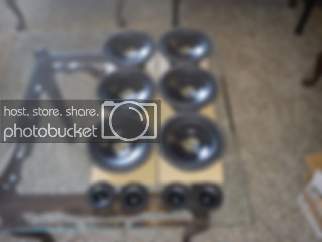

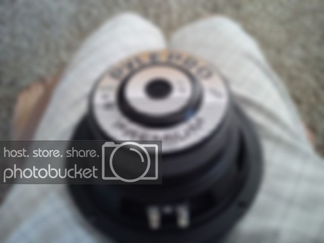

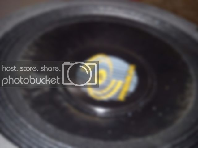

got the mids and tweets in. i must say, i truly under estimated the build quality of the mids. for 10.45 a piece i was not expecting much but ****! I MUST SAY build quality is outstanding! coming from china i expected to see chipped ferrite, sloppy glue iffy tripple joint etc. well no. thats not the case. everything is perfect all the way down to the dang dustcap. +1 for pyle. oh and i tested one and it sounds GREAT! Now the tweeters i didnt expect much either. they are very nice indeed! I was going for as chepa as possible active front stage for others to follow. it should turn out amazing in the end! now the fun part of fitting three 6.5's in the door of a ranger! BWAHAHAHAHA! might have to go with two! here are pics:
Sick! Cant wait for this build to be complete. I wish I knew how to fiberglass //content.invisioncic.com/y282845/emoticons/frown.gif.a3531fa0534503350665a1e957861287.gif
But congrats on the Pyles and the Vifas, I have heard nothing but good things about those Vifa tweets.

Cool man.i'm trying to finish by mid Nov. If all goes well. The tweets are going on axis in the pillars. They are pretty warm little guys.not harsh at all. Hence on axis.
