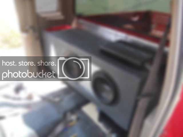

PICS:
t400-2

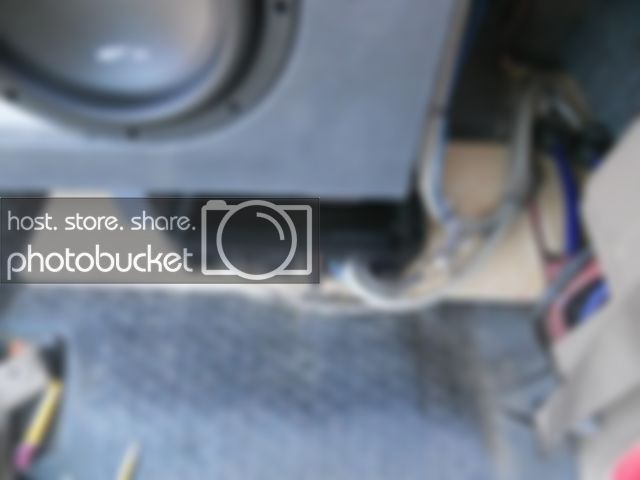

ZRS-C65

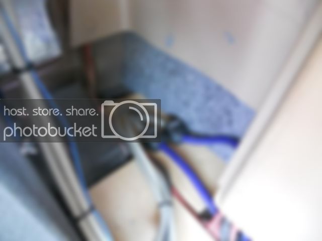

distro center lol

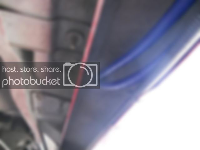

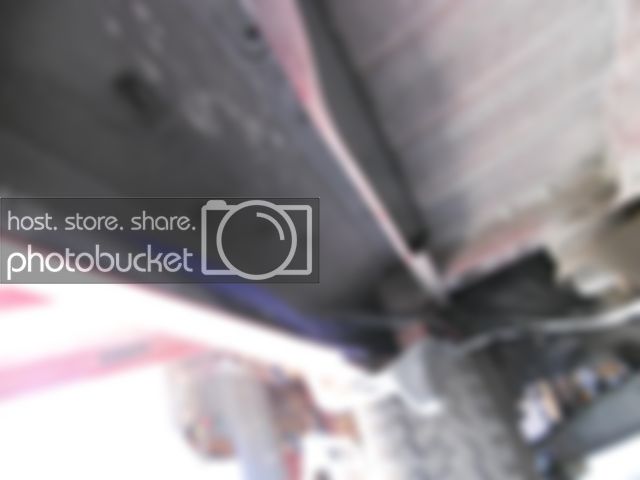

power and ground run

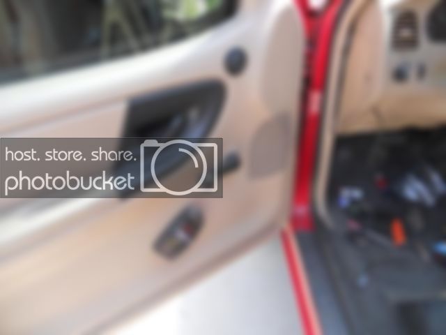

Driver side component
