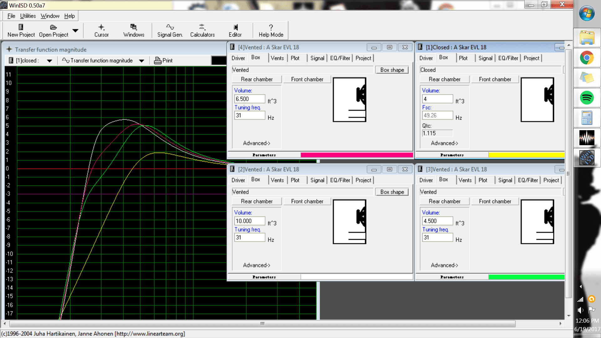

This is how the EVLs look in a sealed, and a manufacturer's 4.5 cube ported tuned to 31hz, a 6.5 cube tuned to 31 hz, a 10 cube tuned to 31hz
As you can see the 10 cube box is the smoothest response next to sealed.

ideally you want it to look like the sealed one. The EVLs are not sound quality oriented subs by any means of the imagination from what the sub's electromechanical parameters tell us. The manufacturer's 4.5 cube recommendation is complete garbage as well.

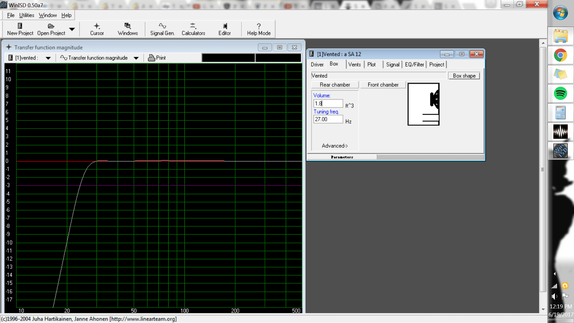

Here's what a flat response SQ tuned box would look like.
Yes I do know THAT!..lol! But this is winisd right?.. I've had the most frustrating time trying to figure this software out... I'm sorry maybe it's because my mental acuity is less now since I've had a stroke.

I'm just going to say right now that that winisd really works!

That drastically changes.
Type in 350degrees in the box next to voice coil temp.
No shift cms down 20% up qes 15% shif vas up 10%
And QL should be 8 for a good sealed box
