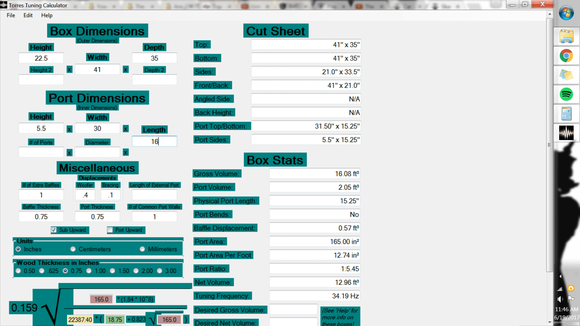

I did worry about that... the site says 24 in2 each but that 81 in2 for 2 sure looks like a hole in the box... http://i.imgur.com/BgrwbZT.jpg ... any bigger and I was told it would be peaky... I'd love to learn to use winisd... I tried to download it tonight and the program I got wouldn't let me exit!! Maybe I'll keep trying to learn torres and one day I'll get it! I am still trying to learn...

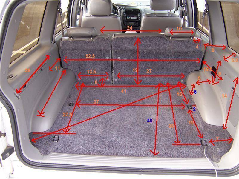

This is the amount of space I'm working with do you think I can put a 13 cf box back there anyone?

It looks feasible with about 12ft3 and that will leave 3ft3 for port displacement. I'm just using the open area measurements... LOL!.. I'm not going to get into using all the nooks and crannies or above the wheelwells but I'm sure it can be done. Man... I've done similar boxes before but halfway through I wished I'd just paid someone else to do it!..LOL!.. of course that would be port/subs up at 12ft3 net. That's at the window line maybe an inch above it.

Fits but it will be above the windowline. If you can build around the wheel wells, you'll get more airspace and will be able to keep under the window line.

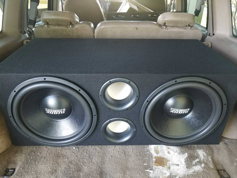

Do you think I can fit 2 18s and also keep the box below seats or would I have to bring it above seats. This is current box it's 5.8cf
That adequate for 2 18s correct ? And I'm getting it built tbh by a bodybuilder and u recommend building on top of the wheelwell?

actually what sub are you going with? Letting you know that the skar evl 18s work better in sealed or 4th order bandpass enclosures. In order for the skar to really shine it needs 8 to 10 cubic feet per 18 once i ran up the specs and modeled it out. That box design down below fits an Icon more.

At this point I am stepping back... I don't use the same program as others... I use this... Port Length Calculator ... I know a 12 ft3 will fit... but if your looking for exact numbers let someone with better software help. At 12ft3... yes, it should be at seat height.
