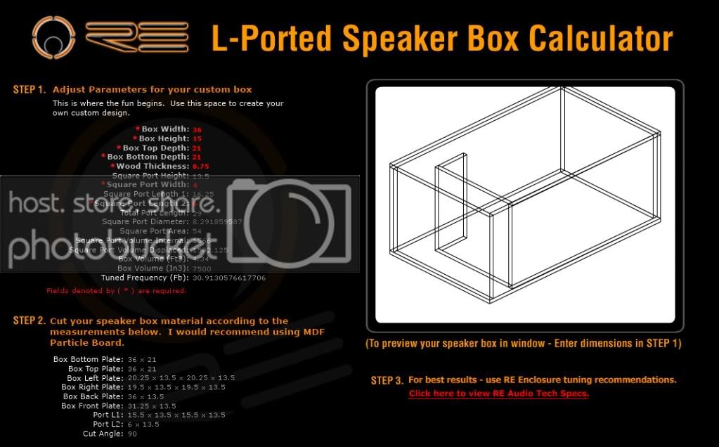

well this *****. now I snapped the 1inch wooden dowels in my box amazingly. how should I brace it now lol. The whole box is together. I might just do a big piece of mdf front to back and top to bottom. Probably mess up the air flow tho.
If you broke 1" dowels, you are getting some severe flex in your enclosure. Without seeing the box its hard to say what's wrong, but it obviously needs some TLC.
3/4" mdf? Double baffle? Post some pics, cuz breaking internal bracing like that is unusual.
with the dowels it was 32.14hz. 1.5" top where the subs are with port back.
