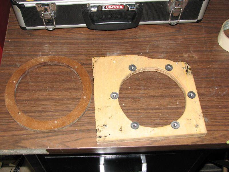

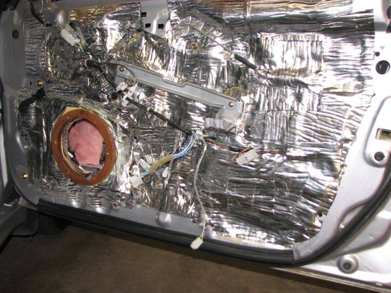

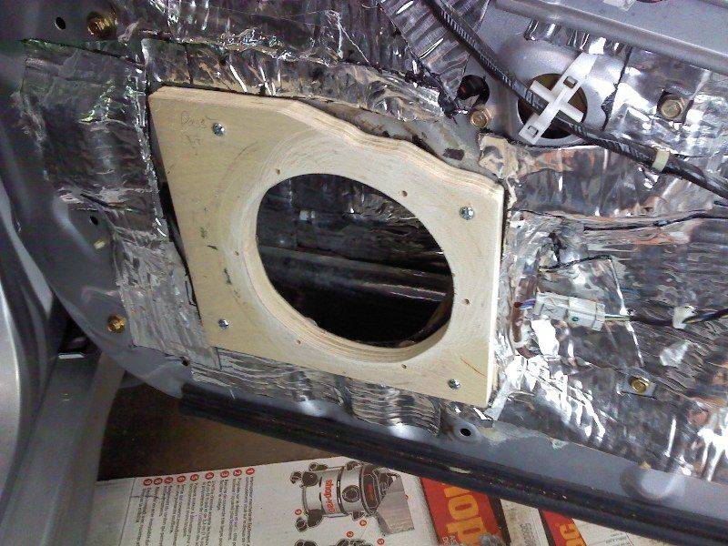

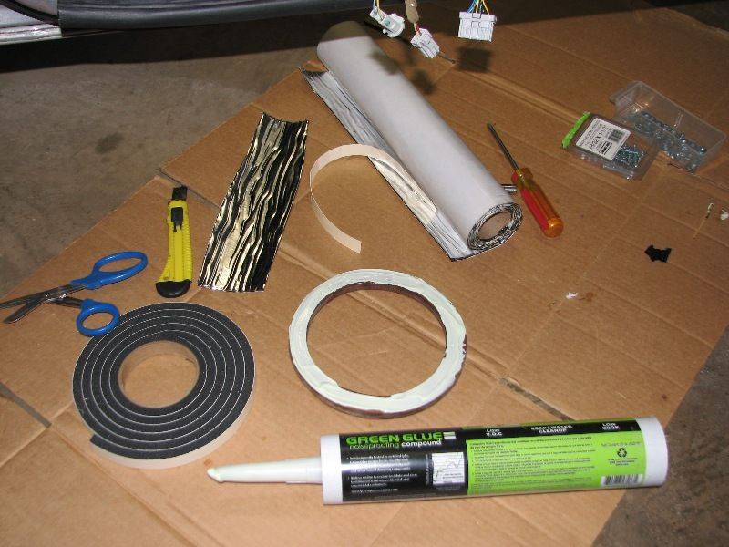

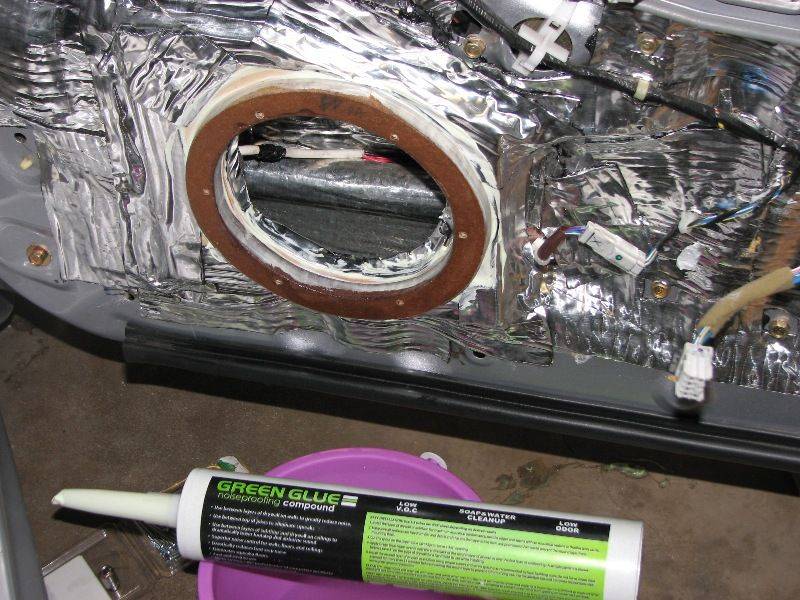

mounting base

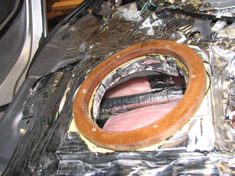

hurricane nuts and a MDF ring (coated in resin).
Green Glue between ring and base

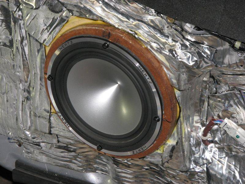

Speakers mounted
Other speakers used:
Foam around front to seal against door panel

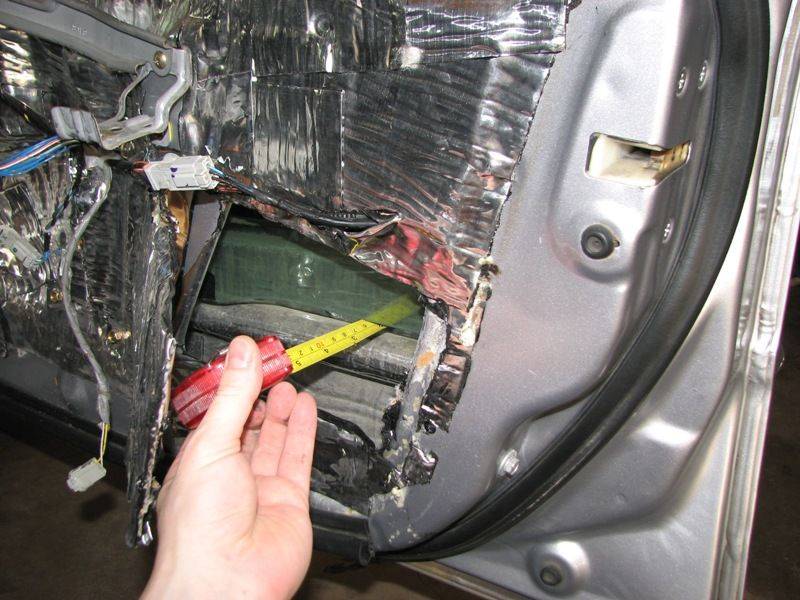

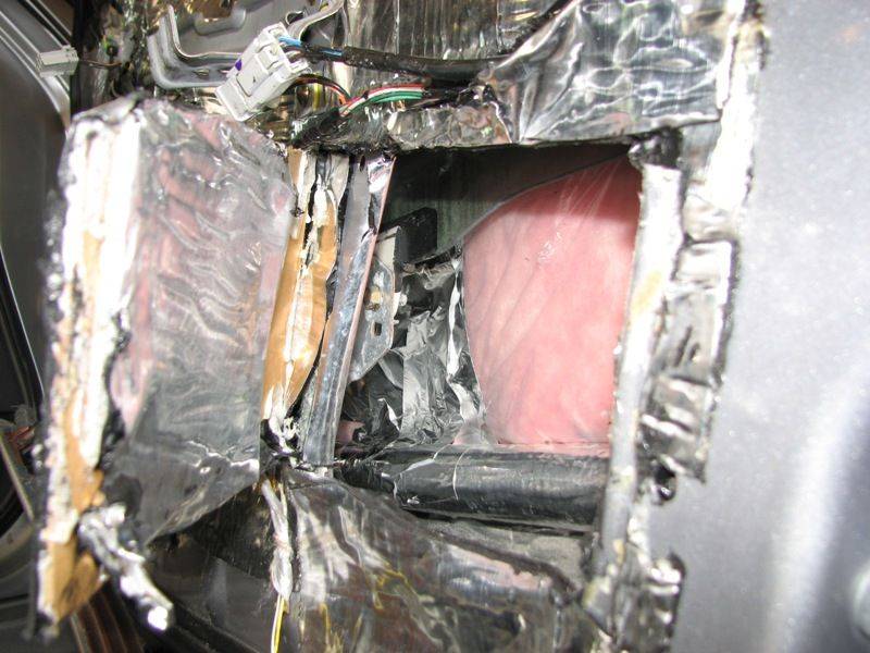

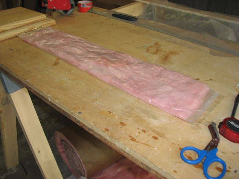

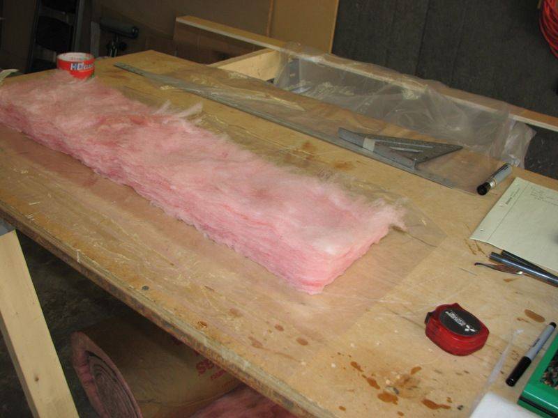

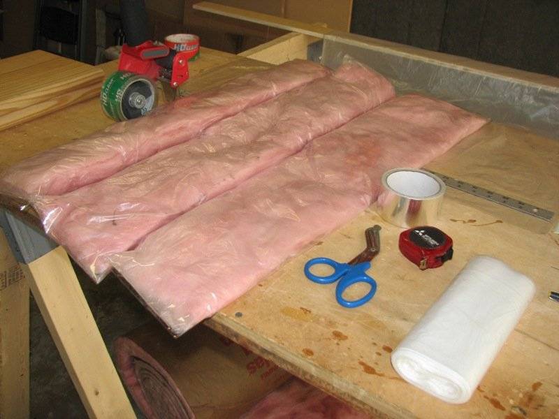

in order to control the rear wave from a speaker and lower reverberation inside a hollow door, i use pvc encased fiberglass absorption. i've seen people use foams or polyfill but those have issues. foams aren't absorptive enough (especially if they are closed cell). polyfill isn't absorptive much as-is. the doors get wet so any fibrous material will hold water = growth and smells.
in architectural acoustics, we use pvc encased fiberglass batt to cheaply add a lot of absorption to a room.
i started with 1 mil PVC sheeting - it is normally used as a drop cloth for painting. it was stupid cheap, like $3 for a roll. i have some fiberglass batt insulation as well. fiberglass batt is one of the absolute best materials for sound absorption. the concern is that you don't want it getting wet. moving forward, i may use UltraTouch insulation just to alleviate the issues working with fiberglass. rigid fiberglass panels are another option and they alleviate issues with the bags being loose.

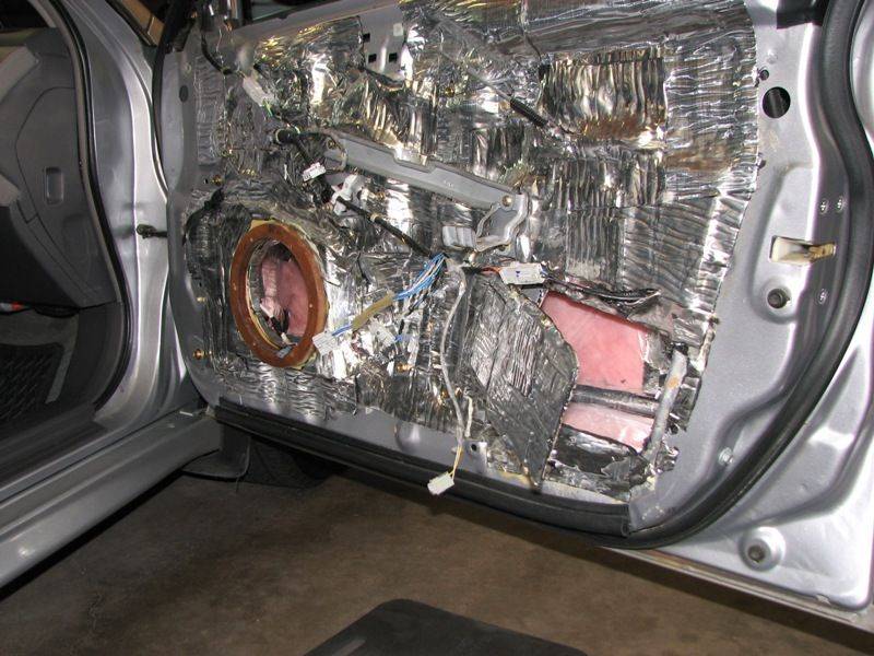

i measured my doors, they have two metal tubes that provide structural strength. i will fit absorption between these. if i had 2" thick bags, they wouldn't interfere with the window. my doors were already sealed up, luckily i used several smaller panels to cover the gap, so i just cut and peeled one of them back:
i needed 6" tall, 30" long, and 2" thick bags. i cut out 18" tall by 33" long sheets of PVC.
i wrapped and compressed it for covering. i used 3M Duct Packing Tape to create the seal.
i made three of them for the passenger door
then i placed them and used aluminum foil tape to hold them in place between the bars
the window guide came down in the middle. this was a snag/tear possibility. so i covered that portion with aluminum foil tape to protect it.

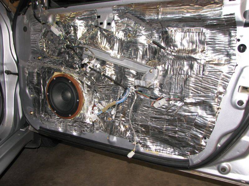

all done, 100% coverage along the entire outer door skin, with a fourth smaller bag stuffed up near the hinge airspace
closed up with a few layers
driver mounted.

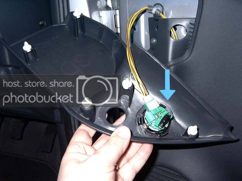

One thing im stuck with now, my tweeter detached as the sealant has split, my tweeter sits something like this but with a load of silicone around it to hold it in place
Can i go and use any sealant to stick it back in place? i remembered reading about letting Caulk dry before mounting a sub in a box as caulk gives off bad fumes when curing, is this true? Do i need a solvent free adhesive?
If not ive got a few different silicones i could use

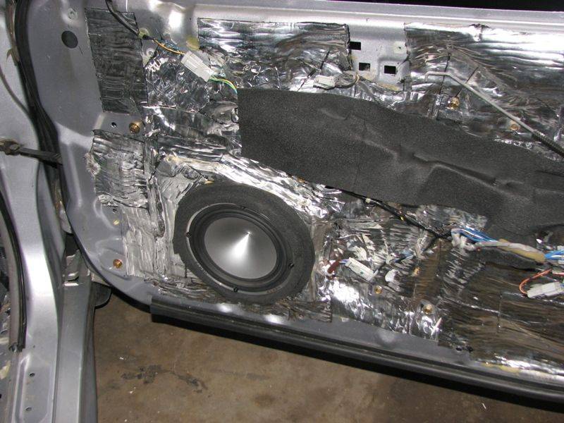

I'm hesitant to post these. This isn't the prettiest way, and these are older pictures from the past, but none the less was very effective and shows you the concept.This is the way to mount the mid.
Basically foam sandwiched between everything.
Between baffle and door, between baffle and and speaker, between speaker and trim panel.
Here i tried to make a ring around the speaker with foam to close the gap between speaker and trim panel. Not pretty, but it did close the gap. (That's the Exodus Anarchy by the way, great speaker)

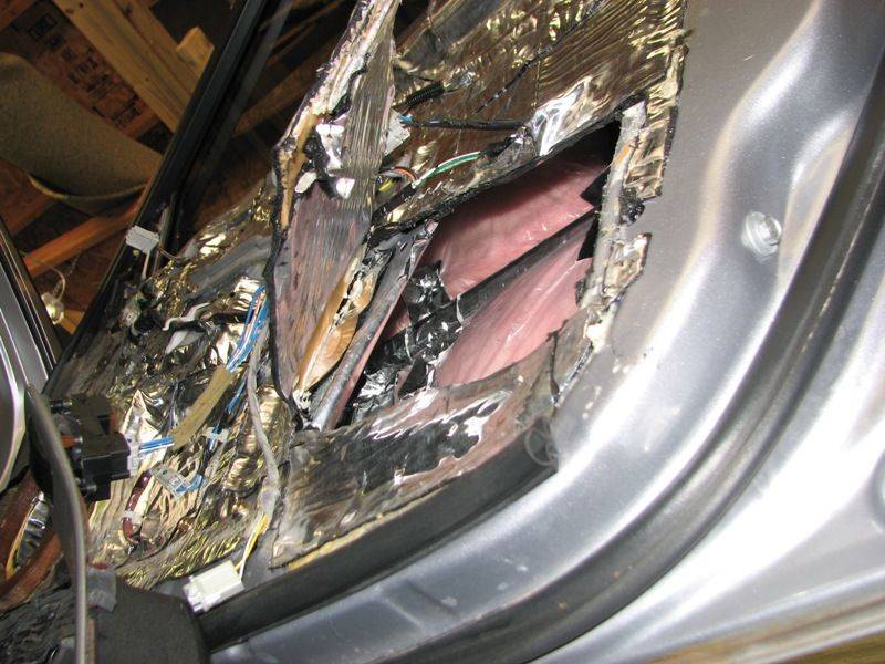

Deaden the outer door skin (the outside metal door panel. Look through the access holes you'll see the deadener)
Cover and seal access holes with waterproof material. (I used cardboard as you can see. Bad idea. It's not waterproof. I got lucky, i checked the other day after several months and the cardboard is unaffected, still a bad idea)
Then completely deaden.
a lot of knuckle heads here will recommend minimal coverage of deadening, but your best results come from 100% coverage.
