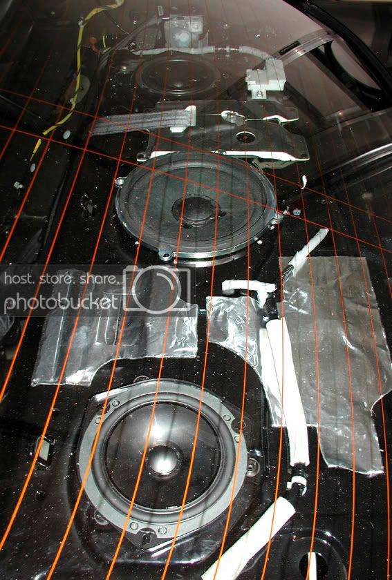

I have a 2006 Acura TL with a ported 1k watt subwoofer in the trunk. I just ordered some Dynamat to stop my trunk lid and rear deck from rattling like crazy. I want to take the stock sub out of the rear deck and was wondering if I should leave the hole open or close it off. I would think leaving it open would make the bass louder inside.
Here are two pictures I found of the rear deck:
RearDeckDynamat.jpg~original
no.
if you fully seal the trunk you greatly limit how much bass gets into the cabin from the trunk. leave that opening there.

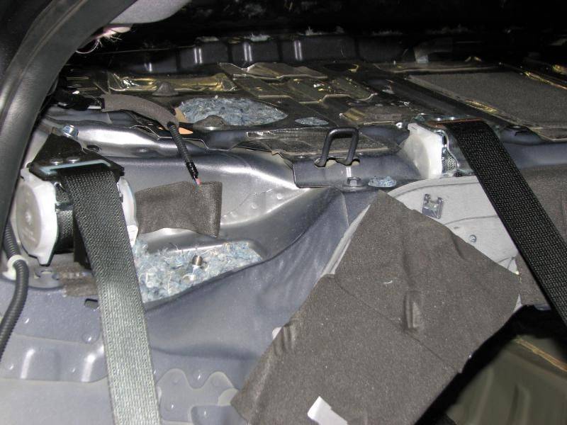

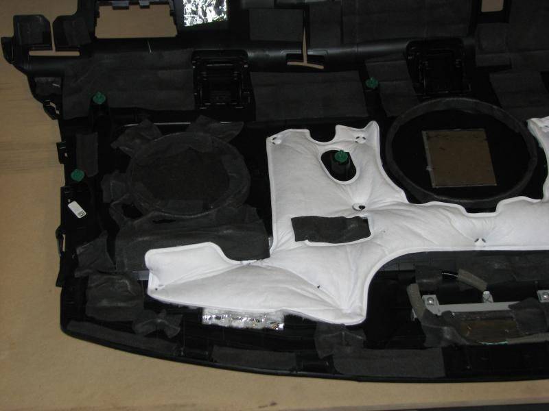

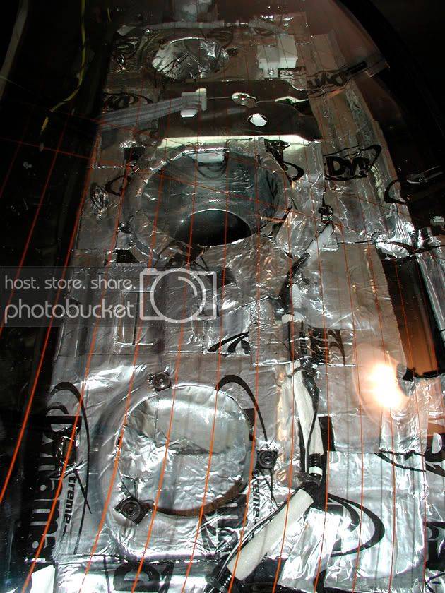

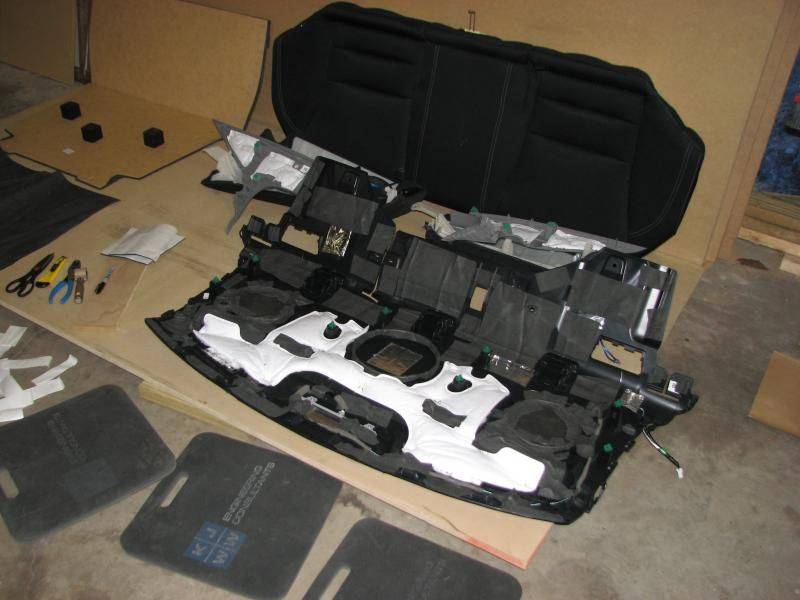

dynamat won't eliminate rear deck rattles, it reduces metal resonance. the rattles are from plastic vibrating against the rear window or metal. what you want are foams or fabrics between the rear deck plastic cover and the rear deck metal. you may also need to actually fasten the cover to the metal to prevent it from rattling against the glass. this can be done aesthetically with screw caps that match the color. i knock on the panels/metal to listen for ringing or buzzes during application. I also fill all voids with acoustical insulation to reduce resonance.
simply put - put soft stuff between the hard things and the rattles go away. sometimes simply adding a piece of rubber between the 3rd brake light and the rear glass will do the trick.
Thank you for the information. I was thinking of getting some thick weather stripping to place between the metal and the rear deck cover. Since you said most of the rattling comes from the plastic hitting the metal and window, do you think dynamatting the entire rear shelf would be pointless, with the exception of the sub hole, or should I just place a few pieces on it?
not pointless. bare metal resonates and is audible. knock on it and listen for how long it rings. add deadener until the ringing is gone.
