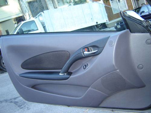

i have a quick follow up question. my celica uses 6.5s in the rear, 6.5s in the front (in doors), and tweeters above them:
the 365 slc rainbow kit is 2x6.5s, 2x4s, and 2 tweeters. the tweeters i can just trade out. but i'm not sure what to do with the 6.5s and 4s. i was thinking of disconnecting the rears, and figuring out a way to mount both the 6.5s and the 4s in the door where the stock 6.5s were. i figured it would be a waste replacing the rear 6.5 stock speakers with the 6.5 rainbows and then replacing the 6.5 stock doors speakers with the 4 inch rainbows.
any thoughts?
Whatever you do do not put any part of that component set in the rear.
You can choose to delete the rear speakers altogether if that is your preference (many people run with a front stage and a substage with no rear fill at all so that wouldn't be an unusual practice in the least)
But if you were to put the tweeters and the midranges in the doors and then the 6.5" midwoofer in the back you will completely destroy your staging. Information that should be coming from in front of you (or at worst from directly beside you depending on how the final install ends up) would be coming at you from behind.
This is a bad idea //content.invisioncic.com/y282845/emoticons/nono.gif.eca61d170185779e0921b0faa9704973.gif
If you cannot put both the 4" drivers and the 6.5" drivers in the stock door speaker location then you'll want to install them in something custom fabricated whether that be by you or someone else.
Door installation is an option, certainly, but I reckon most will suggest locating them in some custom fabbed kickpods for best staging.
Or possibly the midwoofers in the doors and the midrange drivers and tweets in kickpods...
should i just run the headunit outs to the stock rears or just forget about them altogether? they probably won't be able to compete with the amped sub and amped rainbow components anyhow.
