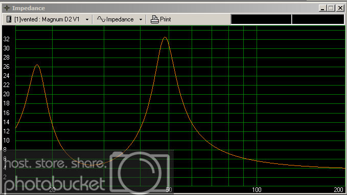

Its AC, Ohm's law doesn't work so well. Impedance isn't resistance and is largely frequency dependent (among other things in audio). Clipping is not THD either. Different animal altogether. Harmonic distortion will always be present, clipping is appraoching square waves (not good). There's a LOT of VERY inaccurate info floating around this site (not meaning just this thread, but in general). I guess if all you're after is loud (as opposed to clear) its a moot point. Rattle your lugnuts loose if that's all you're after. Who cares if it sounds like shit so long as its loud, **** the torpedoes!
Like McIntosh said, the DC resistance might be 1 ohm, but the actual impedance that your amp sees isn't. It looks more like this:
This is for my Mag in 2 cubes tuned to 27 Hz. I'm not sure how accurate it is, but you can see that it sure isn't constant.
57v x 57v=3249w @ 1 ohm...but you are probably not even close to 1 ohm after rise so this is pointless.
3249/ 3ohm (after imp rise)= 1083w...this would be a little more like it.
^^^Not sure how accurate or if I'm forgetting something.
Setting your gain with a DMM on an amp with unregulated output is near pointless IMO.
