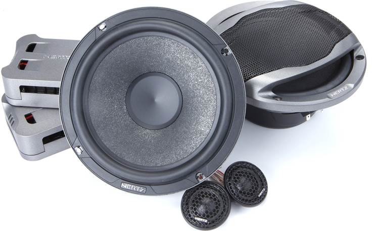

I have the Hertz 6.5 Centros.

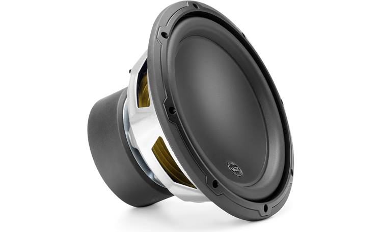

The subs are JL Audio 10W3v3-4’s.
