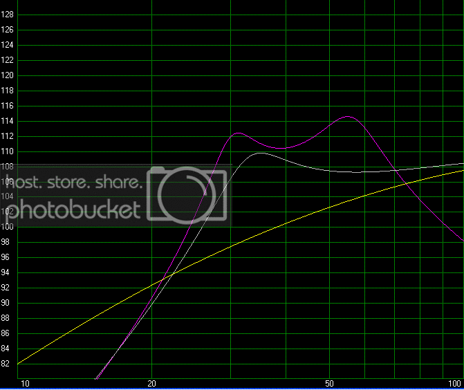

That gives you a perspective on why you arent happy. The RL-i's T/S parameters lends it to being a ported enclosure woofer. Each of these is with 300w. 0.8cuft sealed, 1cuft ported and my bandpass enclosure.
Agian I must stress that WinISD is the worst box modleing program and the responce graphy is likely extremely inacurate. But it's free and I dont know what happened to my copy of BBP6. //content.invisioncic.com/y282845/emoticons/laugh.gif.48439b2acf2cfca21620f01e7f77d1e4.gif
