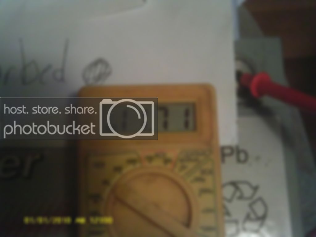

Just got my new batt in and it was charged and testing at 12.7 but 30 hours later I get the batt and it read 11.6 or so???
I have it on a 6amp batt charger right now to see if it will hold a decent charge above 12.5 or I dnt want it. Gonna load test it also I think it has an issue. Whats ur guys thoughts??
Should be reading better than that.Charging with battery cables with the vehicle for about 15 min,I know gas isnt cheap, but neither is that battery.Id try that out.You could have a bad charger too??

I have 3 sprinter batteries all were sitting around 11.5 when I got them after some tlc time with a charger they rest at 13.5 and are good enough to hold up my 4 amps and keep me goin so a lil time on a charger and you should be good //content.invisioncic.com/y282845/emoticons/smile.gif.1ebc41e1811405b213edfc4622c41e27.gif
any batttery should rest atleast 12.6
actually not true,sorry josh,anything 12 volts and over is usually fine.put it on the charger dennis for 24 hours and load test it or let it sit another day or two ,then check the voltage.if under 12 after all this or load test's under 12 then it could be bad.
