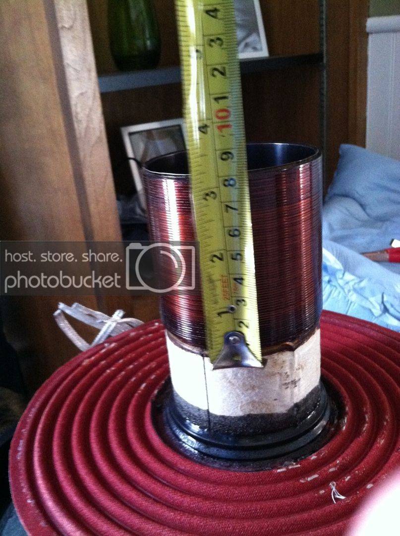

would that indicate a 4 inch 4 layer coil would be better than a 3 inch 8 layer coil due to heat dissipation, does motor size, density, and weight change the thermal capacity the coil sees? understandably overall thermal capacity increases, but specifically the coil.
The layers in a coil affect heat dissipation. More layers = more air between layers. That males hot spots. Also more coil volume equates to longer dissipation time of the mass. That's why fools put longer coils on motors to get better power handling. Takes longer to get hot. But at the risk of a hard bottom, increased cost and increased mms which hurts efficiency. If you were aiming for a high fs you would then need a stiffer spider to comp.
A 4" 4 layer would cool more efficiently due to increased surface area and decreased mass. Motor plays some role in thermal rediation causing the heat to be wicked into nearby materials which is why any motors are black and tolerance between former and pole is very important
Fools put long coils in? So my nsv3 with a pretty dang long 3" coil is made by a fool?? Interesting
If you take my statement out of context that's a bit foolish Ya.
Average reconers can "increase" power handling for a customer, almost always done by stiffening spiders and a longer coil. If designed right and the motor can actually use the coil length it's good such as your situation.
I have to disagree what you here.
I've found that a longer 4layer coil with a larger topplate is a better option than a 8 layer coil in many cases. Not only that but it gives you more xmax.
I'd also rather in some applications perfer stepping ul to a 4" coil.id agree they have Superior cooling over the same length 3" 8layer coil but it doesn't take long for them to get extremely heavy. Although mass for the most part isn't a huge deal it much be accounted for and if you can keep it low I'd suggest you do so..
