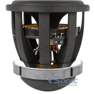

Maybe I'm crazy but I'd take a XXX or MT over any Sundown.
I mean, das so ****.
poor quality. little known fact, the xxx was supposed to be neo originally but cost wouldn't allow. the top plate, IMO is more suited for underhung. its not a very saturated structure either. the tinsels are sandwiched and the MMS is nuts which hurts efficiency
But with enough power it has 4" of throw, great sq, low as ***, and it's arguably the best looking inverted driver. And as far as I know the material quality is good.
gobs of power indeed to get anywhere near 4" peak to peak and even then it wont be near linear travel nor BL curve. its low end response can be attributed to the great MMS. the coil should be American wound (if hey haven't swapped to china)
