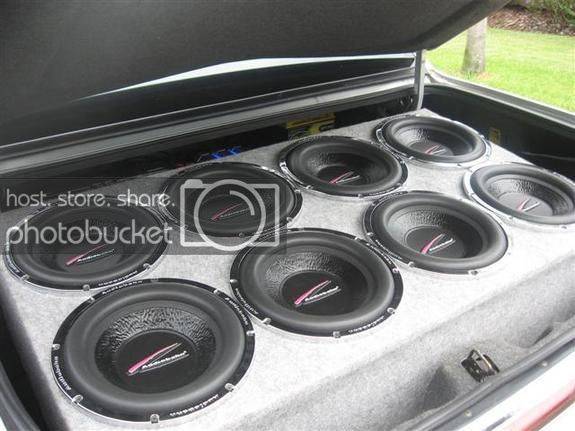

Don't listen to this **** lol. If you know you want to go sealed go sealed not everyone needs to go ported nor wants the ghetto banging pos suv. I had a similar conundrum as you when doing my system. I could go smaller and ported or do what I did and I do not regret it for one second it's plenty loud for me.
