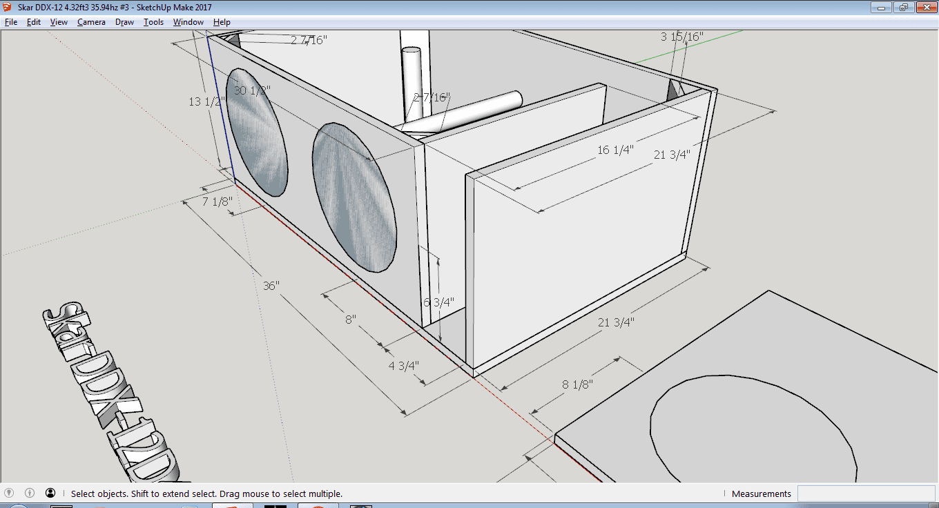

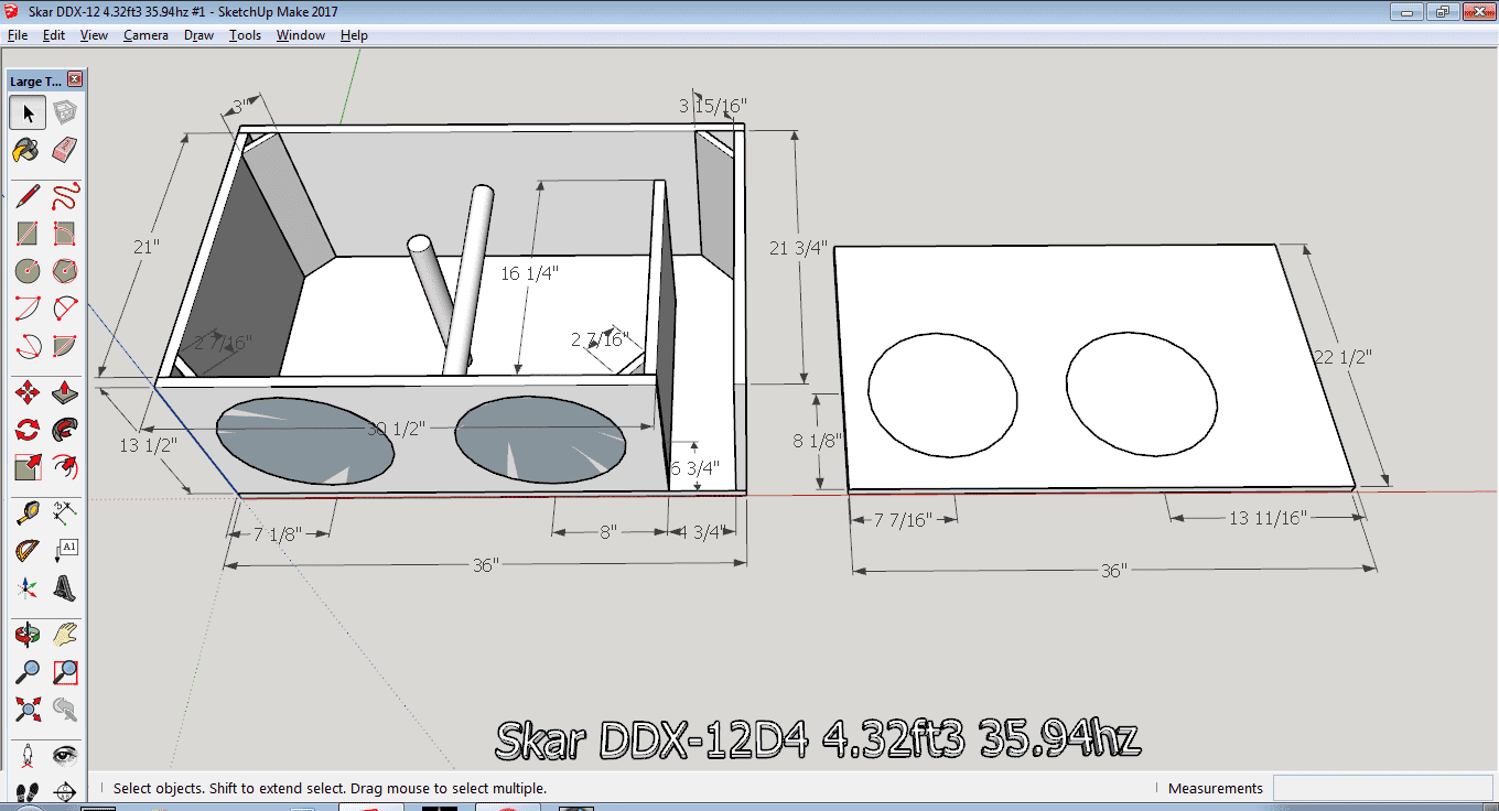

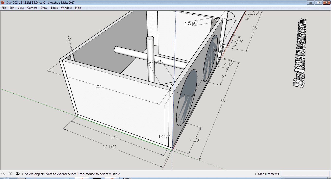

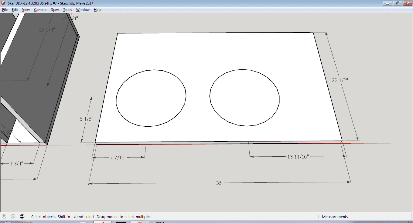

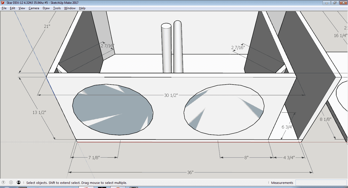

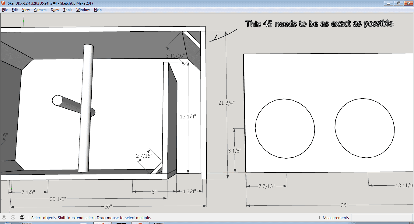

I'm playing around in Sketchup lately, tryin' to refine my skills... I modeled those DDX in Winisd for the h*ll of it and drew something up that'll let you take advantage of the additional power handling if you ever upgrade amps. I used a +2K input signal to size the port area so upgrading the amp would really let those subs open up.
I came up with a tune just under 36hz in about 4.25 ft3 net that looks like a great daily that'll get pretty loud if you ever upgrade the amp, I used 2500 watts when modeling it in Winisd. Can you fit 36" width x 15" high x 22.5" deep?
