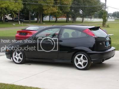

Well theres the thing Im kinda trying to plan out my future install to make sure It doesnt put me into some upper class I dont have a chance in hell at. I drive an 03 focus 2 dr hatchback similar to this

2000 Ford Focus ZX3
