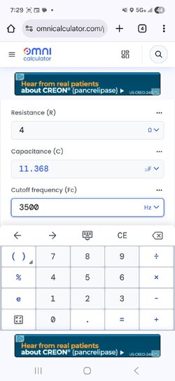

This is what I got from the calculator? How would inuse that to find the ride inductor? Looks like on PE they are all rated by mH. Not sure what that is
pick the RL filter (L is an inductor). It's the one that works when you have the inductor in series with the resistor (the speaker). Sorry about not mentioning it.
inductors are measured in Henries. mH = millihenry. uH = microhenry. So 1 mH = 1000 uH. So the calculator will give you about 180 uH or 0.18 mH.
