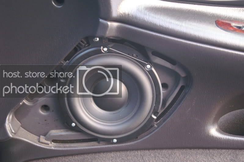

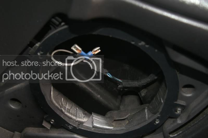

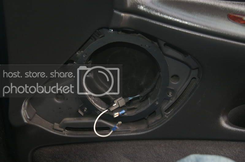

I have read all of these pages myself. What I am confuse about is; In my car the speaker is mounnted in the door panel itself. There is good room in there. I have an sls in there now. I wanted to do a better job of mounting this speaker. Along with adding some cld tiles to the outer shin with some mass loaded vinyl. Should I cut thru and mount to door or leave as is. Here are some pics of the situration.
