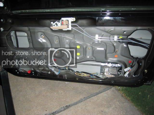

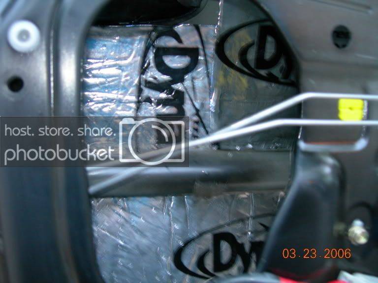

Heres the door CLEANED... one whole day cleaning both doors... i hope applying dynamat is much faster...

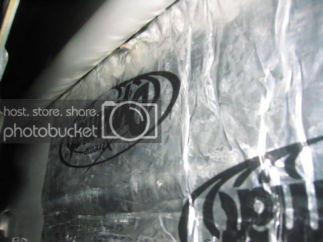

I do have a question though. In this pic you will see i put dynamat over the metal bar as well. MY question is, do i cut and put on an extra piece to cover the metal bar and use other pieces to go on the flat surfaces or does it not matter and i could cover up the flat part with the bar with one piece of dynamat?
Do i do this and put on seperate piece for the bar or
altogether like this?
Lastly, is 2 layers on the outer most panel more important or 2 layers on the inner panel more important? What do i do about parts i cant reach in the outer door panel? Just ignore it?
Thanks
Well first of all nice job on getting your doors prepped...**** those are clean!! In my door I just skipped the reinforcement bar all together I think. It looks like you got the skin well enough underneath the bar by the looks of your pics.
I would say that you would defineately want to put that second layer on the inner panel where the speaker is mounted rather than on the skin. Dynamat will help with a little with road keeping noise out and keeping your stereo noise in, but if you want to keep the road noise out then you want to use something like carpet padding or closed cell foam. If you've ever seen a recoding studio, the walls are covered with acoustical foam, not Dynamat!!
If you can't reach way up in there, then you can't reach way up in there! So yea, you will have to either ignore it or get really creative.
Nice work so far. Like anything else, you might as well do it right the first time. Kind of sux that those connecting rods are so long and in the way like that. You should be able to unscrew the handle and get underneath there with out bending them though.
I would suggest maybe rolling it down or using a plastic puddy knife to secure it to the surface a bit better. If you already did then nevermind, it's hard to tell from the pics.

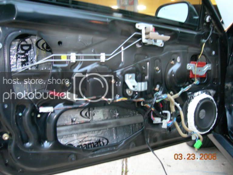

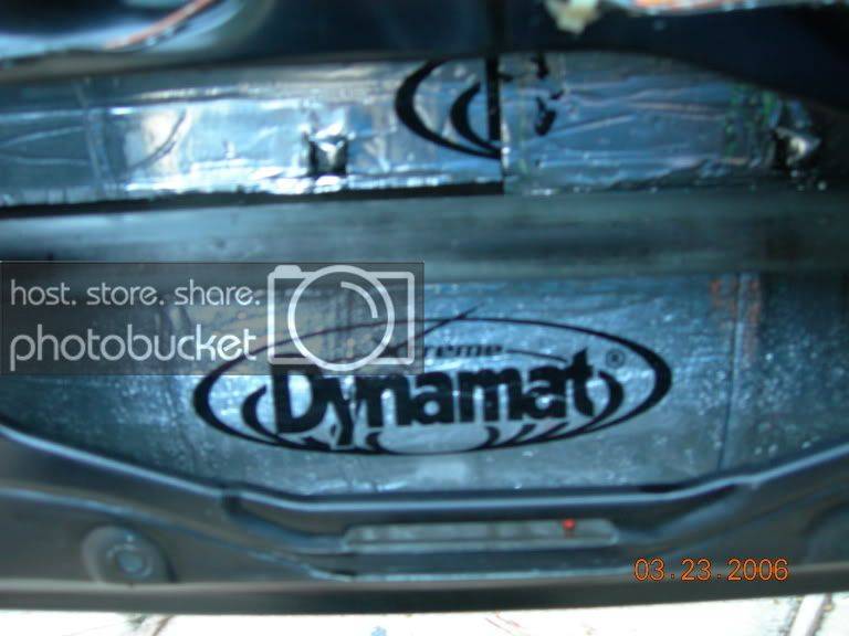

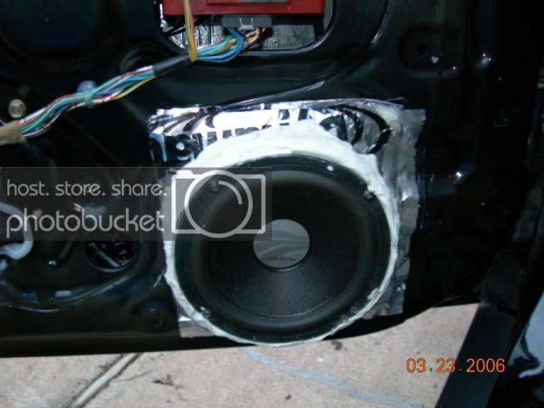

Some more pics of it, i basically completely deadened the outer most skin on both doors, put 2 layers before the speaker as well with new clay and with the baffles removed and realized i ran out of time before my quickie vacation (during Spring Break) and nearly ran out of Dynamat.... //content.invisioncic.com/y282845/emoticons/furious.gif.fc81ca146dbff91fede3ed290dbc4f4c.gif
All in all, i notice a HUGE difference in bass tightness already ( didnt even deaden the inner door skin really) plus when i knock on the door on the outside it dont sound hollow as before. OVerall the 3 days of work were worth it, and i also got a 9855 nicely setup and installed. //content.invisioncic.com/y282845/emoticons/smile.gif.1ebc41e1811405b213edfc4622c41e27.gif

Do the inner skin door. Trust us -- there's more to deadened, especially if you're running those massive midbasses.
The real test is to see if any ungodgly boom, rattle, is transmitted outside while the music is at it's highest inside.
Kind of nice wrapping your knuckes on the outside door eh? Sounds German. Yaaa.

Definitely do the inner door skin, you think you notice a difference now? Wait till you do that. And also, seal up those big *** holes, you seal all those holes up on your inner panel and you'll have a HUGE increase in midbass.

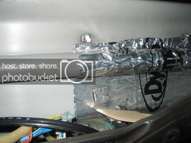

Decado, i still dont know what to do about the door locking bars, its still going to leave an open space up there. any suggestions?

Lil: Yes, I'm currently running the CS265 Profi Kicks and believe me, you will need to line the inner door sking. I'm currently running them with passive x-overs with 320w per channel bridging the Arc 4150XXK. However, they do more than fine at 80w per using the same Arc but unbridged.
thanks
I can't rly see your locking bars, but what i did with mine was got some foam egg crate and packed it in there around the locking bar, it could still move but it helps attenuate. Polyfill will work too.
