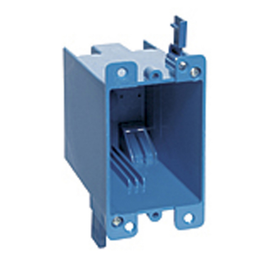

First of all what you need is a "old work box" Thats the name. You will need 2. One for the 120 volts, 1 for the low voltage. Mount both boxes behind where you want the tv. Run romex wire from the new box to the old box and wire it up to the power/plug. Wire up new plug and outlet on wall. Then do the same for the low voltage shit. There are electrical codes to follow. Other wise just bash a hole with a hammer, throw an extension cord down there and hope you dont have a fire and no insurance.
well i wouldn't plug the power wire into an outlet behind the wall that's inaccessible... that's a potential fire hazard, but just routing the cord in and out of the wall wouldn't/shouldn't be an issue at all... it's no different from the romex that wires your house... in fact, it might be more heavily insulated that romex...
This is what I am doing.
Here's another pic of the same type of box. You can see the top ear that tightens up behind the sheetrock and alse the stationary ears on the front that prevent the box from falling back into the wall. This along with the plate you've been posting the pic of will work well together.
Yes. The difference between the pics is one gang vs 4 gang. I am opting for the four gang so I will have plenty of room.
