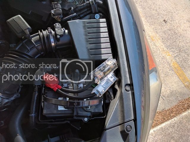

Revisiting this. What I ended up doing is using two runs of 4 awg.

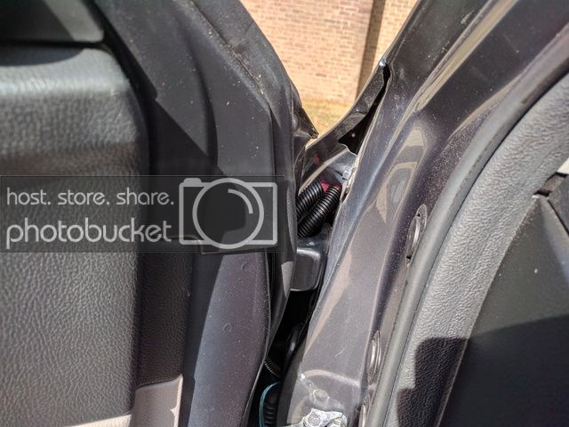

I ran them thru the side of the engine bay and into the door jambs into the main grommet. Turned out decent.
Ran to the back to a couple of 31s and then to multiple runs of 0. There is no bottleneck between the two since I'm using welding wire. I also dressed them up in black to make them non noticable. Absolutely slamming. I haven't done big 3 yet or have my mech man in and I only get slight headlight dimming full tilt.
I cringe when I see wiring thru the doorjamb like that.
And can I ask why your inline fuse holders aren't secured to a solid spot rather than resting on top of what appears to be the pos battery post?? Doesn't look safe, really.
