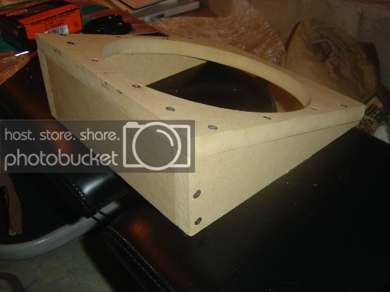

This is the frame for what will be mounted in the back seat's compartment. There is metal between this space and the trunk, so I will be connecting this to the rest of the box in the trunk with fiberglass.

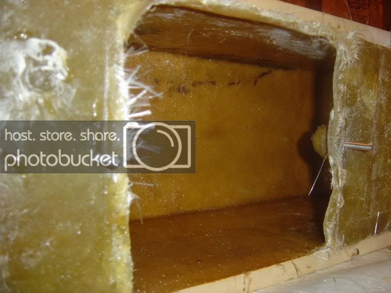

I mounted some bolts into the fiberglass to firmly attach it to the trunk while fiberglassing it to the mounting frame. Also put on the back of the box and put a layer of glass on the inside.

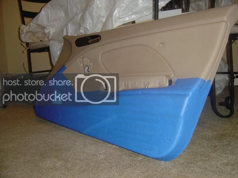

Taped up the door panels to make molds.

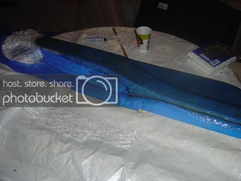

Starting the mold

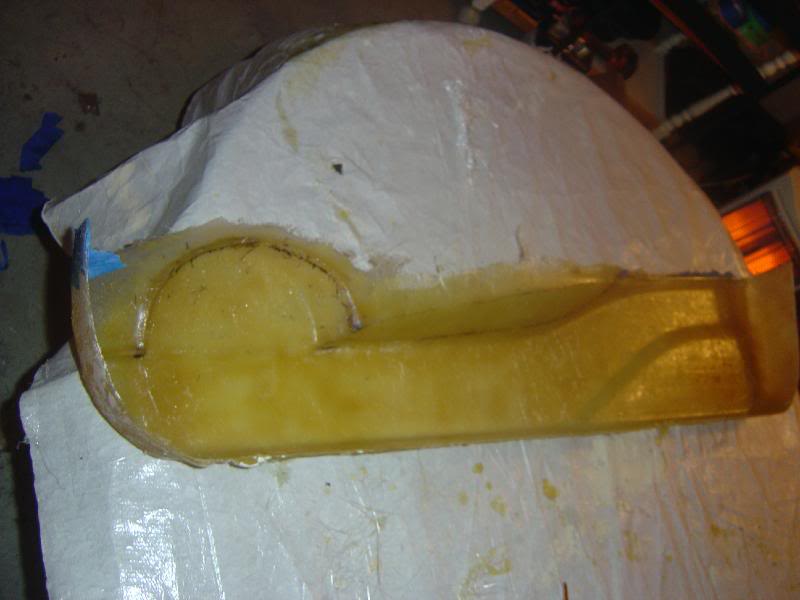

Finished drivers side mold.
