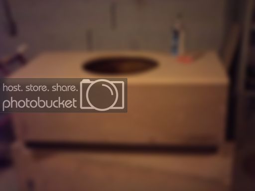

This is the SQL box I designed for the 4hp....ive not had a chance to try it yet, but i'll let ya know how it does //content.invisioncic.com/y282845/emoticons/biggrin.gif.d71a5d36fcbab170f2364c9f2e3946cb.gif
Looks awsome man, what are the specs on it?

Someone wanna check the tuning for me? It is right on 5.5 cubes net, the port is 15.5" tall x 6" wide and 22" long; I got 36Hz in WinISD, just wanna confirm it...
winisd does not calculate the port volume into the equation so you actually have to calculate the port displacement and remove it from the box's cubes to get acurate tuning. probably didnt take your subs displacement out either.
