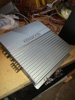

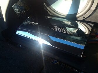

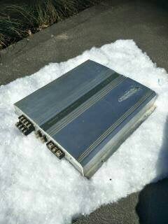

Also keep your eye open of some second hand amps as they will outlast the newer products.  I have a Precision Power PC450 running my speakers and they still are sounding sweet in 2019. and I think they were released in the early 1990's.  Old Kenwoods are also a good gear that was quality built, not sure about the newer items though. The old Rockford Fosgate amps were bullet proof performers as well, even the entry level ' series 1' models. Old Eclipse amps are also solid performers.  Pic of EA3422 4 channel amp attached.  PPI 2600 is a 2 channel amp but they are very good built and with good features.
