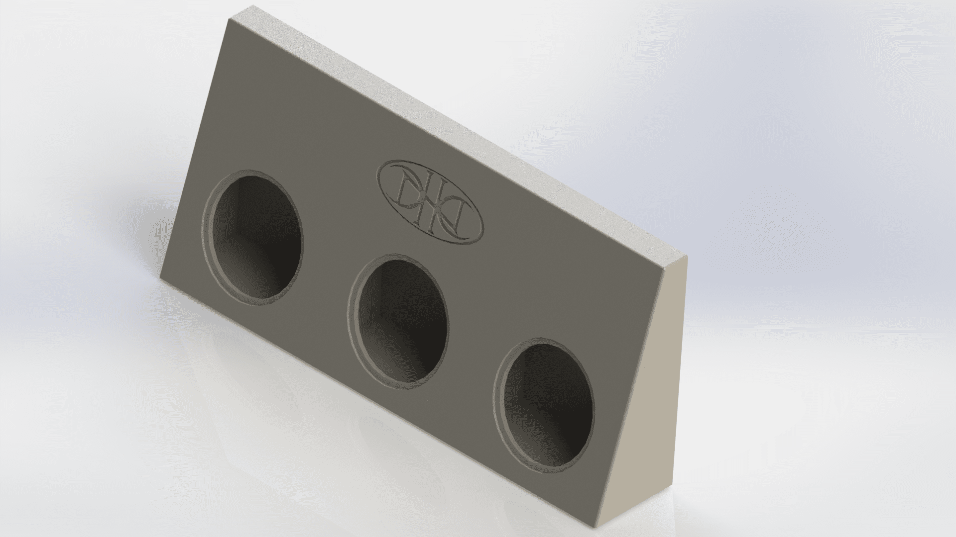

If I go with the JL I will build this enclosure. The tech at JL said .60 (includes displacement) for each sub would be better for low end instead of the .50 that the manual says.
