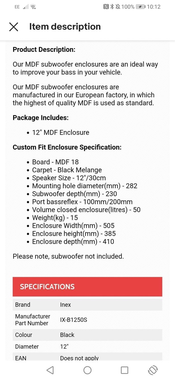

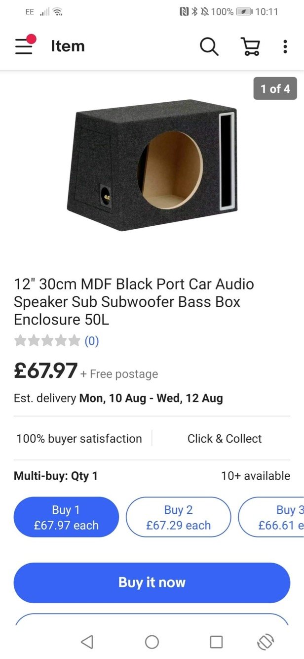

Does anyone know the port tuning of this box?

Anybody's guess but prefab boxes are usually tuned higher than a lot of folks like and they're virtually always too small. Most high power 12's want 2.5 to 3 cubic feet net for ported alignment.... whatever that is in liters so this one is coming in about 2/3 the size it probably needs to be.
Ah okay, it’s 1.75 cu ft which meets the spec of the sub, I’m not certain it’s tuned as low as 35hz though which is where it needs to be
I converted those to inches and ran the numbers, its beyond terrible, absolutely trash bottom of the barrel piece of shit box.
With it being a slot port, and the dimensions they give, its 1.75 GROSS cubic feet. What does that mean? i means its just the total box size which is absolutely garbage. The important number is NET cubic feet which is after you factor in how much space the port takes up and how much space the subwoofer motor takes up. You are closer to 1.25 cubic feet tuned to 45hz with that box. Stay the **** away.

Well in all honesty I’m already running the box with a pioneer sub and it sounds wicked! I paid about £50 for it so it wasn’t a cheap box, just wanted an idea of the tuning, 45hz is okay, I wanted to go a little lower ideally so I may be in the market for another box soon, what makes you say it’s garbage?

you think your sub is good right now... but wait till you hear a proper box with proper airspace. You are choking most subs with this kind of box. However your pioneer might be one of those that are okay with tiny boxes but you will be missing a huge chunk of bandwidth and your bass is peaky and not reaching full potential at all of the sub.

Yeah that makes complete sense, I haven’t really heard many high quality systems as you describe them, it’s hard to get hold of stuff in the UK, I’m looking at getting a sundown sa12 classic shipped from the US and a box custom built soon though

I can't speak for Pioneer subs but I'm betting even that would do better in more volume with more port area and I'd look to tune 37-40hz rage for music (tune down to 32hz if you play that slowed down shit or bass test songs).
I'd also vouch for Type R being very capable, throw a 12" type R into 2.75 cubic foot net tuned to 38hz with 8" round port and it'll knock your socks off.
I've noticed that if you are forced to pre-fab that the boxes are going to be too small. It's usually best to buy a box one size up. For a single 12" you should buy a pre-fab for a single 15". Then, just screw on a piece of 3/4" mdf and cut the 12" hole. I had a single XFL 12" and bought a pre-fab for a single solobaric 12". It tore my 3 series comvertible up. Just a thought.

That's actually a half decent solution though I'd say you'd want to seal off whatever slot port is there and make your own round port out of sono-tube or PVC pipe or something.
